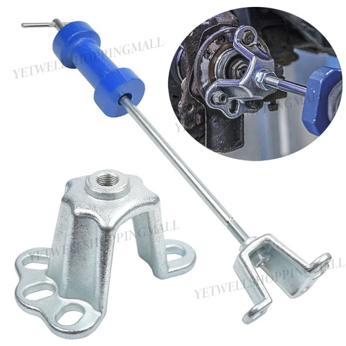

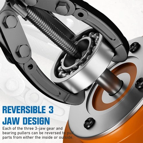

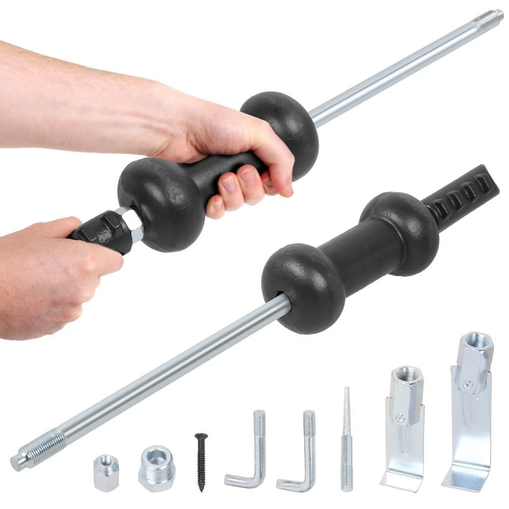

Slide hammer is the best tool for pulling things straight out.  But for this you'll need some way to attach it to the waterpump or pulley.  Possibly a bearing puller might work on the end of the slide hammer.  Might be able to borrow something like this from local garage tomorrow rather than buying it just for one job.
Slide Hammer Puller Set 5 Lb Malleable Steel Slide Hammer Auto Body Dent Repair - Picture 1 of 12
Slide Hammer Puller Set Wheel Axle Bearing Hub Extractor Removal Tool 4 & 5 hole - Picture 1 of 9
3'' 4'' 6'' 3 Jaw Gear Pulley Bearing Puller Extractor Remover Tool 75/100/150mm - Picture 5 of 6

Hmm looks a good bit of tool, But don't think the engine will go that low tbh, Been driving fine since the wet belt then noticed the coolant was dropping then figured out its from the water pump, so silly me has not put coolant in only water and then gone for crank it over and hears the water pump stretch belt screech like hell then loads of smoke, stretch belt snapped and this auxiliary water pump,
