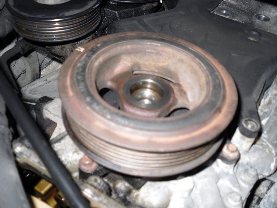

Limited success?
After struggling with the puller (I've never used one before), I think I might have moved the pulley about a quarter of an inch - but I'm not sure.
Looking at the centre, it looks as if it's moved.
I attach a pic and hope someone can confirm either that it's moved a little or it hasn't.
The snag is that I had no more thread available on the puller bolt by the time it had moved that far so (if it has moved) I'll have to see if I can adjust the legs to give me a bit more thread.
This is a real bugger of a job!
Let joy be unconfined! :D
The pulley is off! :lol:
To gain some extra 'unscrewing distance', I inserted two 1p-pieces into the centre of the of the pulley hole and that gave me about an inch more to play with.
A few more turns on the puller and the pulley came off. :P

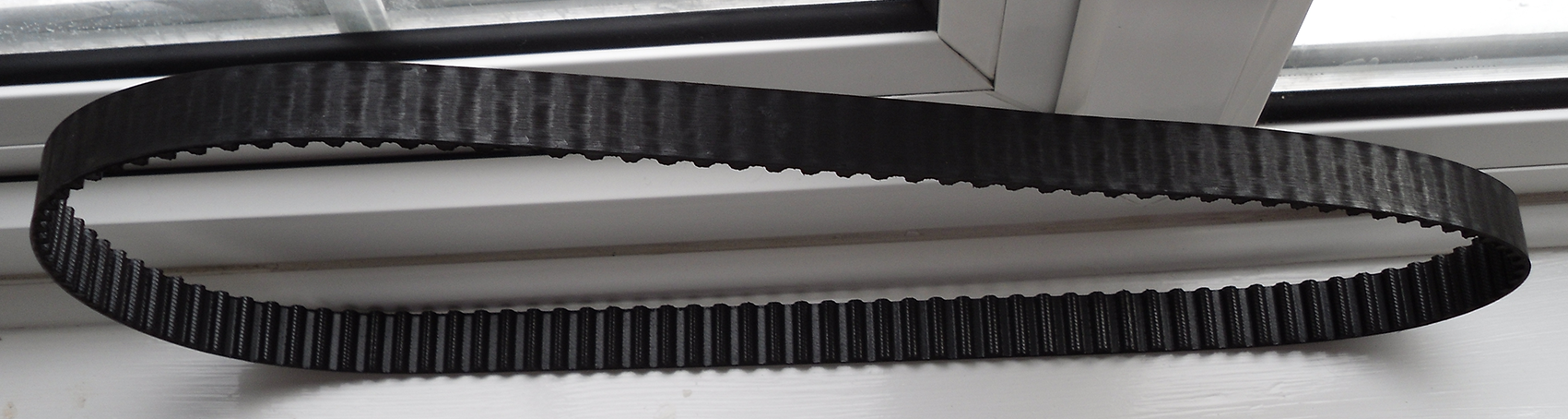

I've just removed the old timing belt and it looks fine to me after 138,000 miles.
No splits, no damaged teeth, and it's not overly bendy.
I'm still going to change it (obviously).
I'm no expert on timing belts but can anyone give an opinion based on the pic below?
