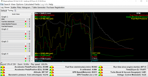

Is it my impression or rail pressure is the first to go?
Detail is not great as this was taken with a chinese odb2 elm bluethoot and torque app.
Pic comes up quite clearly on my system. I can not see any problem with the fuel rail (FRP), it seems to follow movements of the accelerator pedal (APP) as expected, except when maxed out. The max limit of 21,000PSI is about right, I believe it is usually 1500Bar or 21750PSI.
The MAP seems to follow the APP and FRP also, with a little delay which is to be expected.
I can not really see what happens at the end, the APP dips, the RPM dips, then shoots up to a high value. I assume the car was out of gear (or changing gear) when this happened, as the vehicle speed could not have done that. But the MAP did not recover. The more detailed trace does not help much without the APP, which is usually the primary cause of all changes.
You can not rely on tiny time differences between traces at one or two samples level. This data is being extracted over a CAN bus that can only carry one packet at a time, and it is busy carrying lots of other, more urgent, data between all the modules, IC, PCM, ABS & steering possibly. So there will be some variable latency in getting readings. Readings like engine load and vacuum gauge are just calculated from other sensors, so are not essential.
There is also one anomaly between the two APP traces, near the start. It may be just an artifact of the data recording, but worth keeping a watch to see if it repeats.

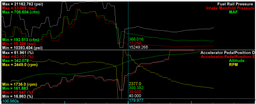

Adding a cleaner picture with the details you highlighted. 🙂

22 hours ago, jorgemef said:
I was uphill and allways in the 6th gear until I got the warning light. I raised my foot, changed to a lower gear and proceed in limited mode
I understand a bit better now. Unfortunately I can not identify a clear cause for the warning light.
I assume the reason for the steppiness of all the traces is the limited sample rate, so making time comparisons within one or two of those steps is dodgy. The big drop in FRP looks like one sample time, and could easily be the result of the ECU going into reduced power mode, or even a response to the APP change that appears just one sample later, the ordering of answers via the CAN bus is not guaranteed, especially as the ECU is busy dealing with what it sees as a fault.
The MAP does seem to drop a bit a few samples earlier, but that could be in response to the small APP change just before that.
If the FRP was the primary cause, I would expect such a large change to raise a fuel pressure DTC, not a turbo one.
The RPM drop matches the FRP drop, so either the RPM reading is wrong (CAN bus or sensor error) or it happened while changing gear, again suggesting the APP trace is a bit delayed compared to the real sequence of events.
