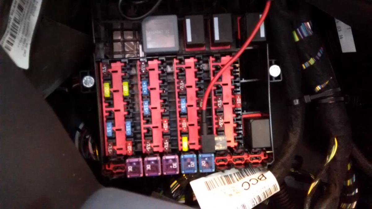

  • The lower slot should be for the original circuit, so put the fuse you took out in their, the top slot will be for your camera. I'll double check mine in the morning. You can connect the earth to a
  • Here we go all done,put the piggyback to the socket lead by 2 bullet connectors and red insulation tape round just for the added protection. Cable ties in 2 places to stop it pulling and another fuse

I have looked at the picture of the fuse box on here,so is it the 15 you have to pull out
for ignition on/off and which slot do you put it back into on the joiner i have.
Did read on here but just wanted to be 100% i have added my fuse box below.

I forget what slot number mine was connected to, but it is the rear wiper fuse which is 15 amp. Here's the photo of my fuse box again so you can see how the fuse piggyback is connected:
With the wire from the piggyback going up, the original fuse goes in the slot closest to the fuse box (on the piggyback itself), and the fuse for your new circuit goes in the other slot. You don't have to connect the piggyback to the rear wiper slot but that works for me, and an advantage of this is that a rear wiper failure is not that serious, but something else failing like the instrument cluster could cause real problems lol.

I took it to a garage to have the work done, but they connected the earth cable to a bolt just above the fuse box. I'm not sure what the bolt is connected to but this must be a suitable earthing point.
Yes i have also seen the bolt to use for the earth,seems a very easy job.
I think fuse box says slot 6 for rear wiper,well ford book does so will see how it goes.
All things arrived so getting there.
Cable ties in 2 places to stop it pulling and another fuse that came on the lead so it has 2 fuses
both 2amp and all tried and works fine.
Just got to see where i want the lead now.
