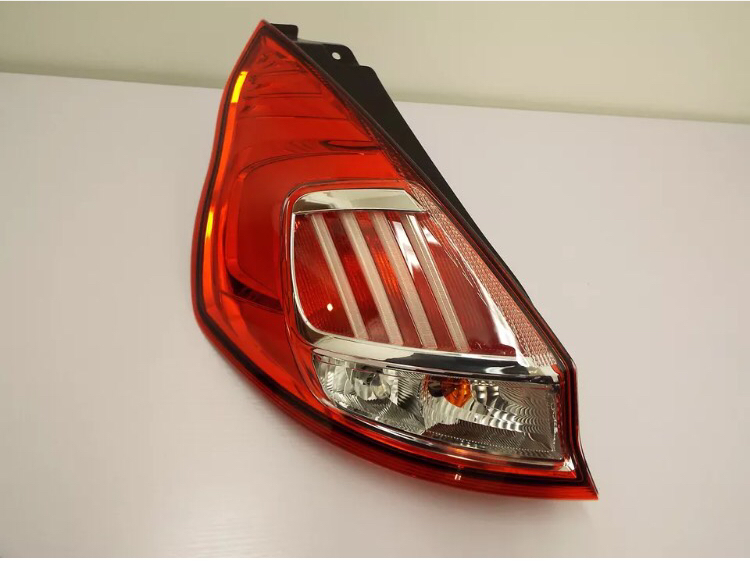

£150 for the pair: http://www.ebay.co.uk/itm/Ford-Fiesta-MK7-MK7-5-MK8-Rear-LED-lights-/262916525182?hash=item3d370bcc7e:g:RIwAAOSwdGFY3T9T

I'm going to stick my neck out here and say that for now forget about the high level light and think about the tail light alone. The majority of the bulbs are halogen accept for the 4 vertical stripes on each unit, these are LED and are the 'signature' marking for the fiesta. @MJNewton there would also be a benefit to have them as indicators too, the flash would be crisper and peak sooner. Not by anything noticeable to our eyes though lol.
That's my interpretation of the blurb and the unit itself.

Might you be thinking of a different model/year Jon? Mine's a 2013 Fiesta (Titanium) and doesn't have any stripes on the lamp housings.
Here's a stock photo of the type I've got:
I am pretty certain there are no LED bulbs in it, despite what ETIS might say.
You're right sorry, I thought you were referring to a 2016+ car. The lights @IanLanc linked to and the comments by @CREED and @karl46 all referred to the 2016+ models/lights. I didn't realise yours is a 2013, apologies.

No problem at all. For completeness I'm assuming these are the ones you mean:
Spot on, those are the ones. Sorry for the confusion, on Tapatalk you can't see anyone's signature

I have a 2016 festa with the later rear lights with the clear stripes. The Ford main dealer said they are not LED, but only look like they are, The same as the earlier ones were brochured as "LED night signature". but were not LED.
LED lamps are usually quite easy to spot given them being so much quicker to illuminate and extinguish.
They 100% are LED strips, if you look at the back of the light you'll see small black and red wires going into the unit. They are not removable, meaning the LED is not replaceable. By the looks of it it's only one or two LEDs lighting up the strips but I could be wrong.
As mentioned above you'll also notice the LEDs illuminate faster(instantly) when switched on which is another giveaway :)
The brake light however is not LED. The only LED part is simply the taillight/sidelight itself.
This is only on late 2015/2016+ models
