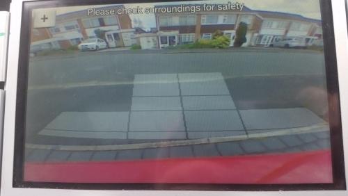

And just one other thing the reverse camera works fine (see picture) but before the sync 3 upgrade there were some guide lines that the wheels track in they have gone!
