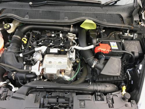

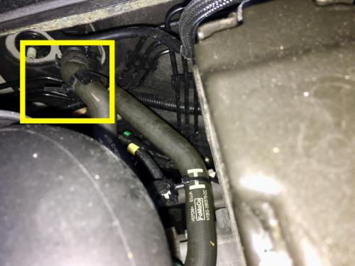

Hi Richard ..tried (and failed) to add these pics to my reply to your message, so I'll try posting them here. I've just been out to my car and taken these. First pic is the engine bay, and the green spoon thing at the back is where you need to look down into to see the pipes. Second pic is looking down there (where the spoon handle is!) and I've put that yellow box around where the cable tie is. It's infront of the pipe separator, it's a nice wide cable tie (about 1cm wide) and it's just tight enough to hold the pipes together, but definitely not tight enough to squeeze or collapse them. Hope this helps!
Is the plastic clip thats holding them together too loose , think must be same on mk7.5 does the cable tie make the pipes tighter and these noises go?
