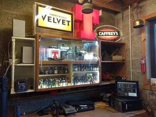

And a wee side project I knocked together with scrap wood I took out of the bedroom and ensuite. A man's got to have a hobby [emoji16] [emoji482]

And a wee side project I knocked together with scrap wood I took out of the bedroom and ensuite. A man's got to have a hobby emoji16.png emoji482.png
Thats the Research and planning department where all strategic planning and epic journeys begin.

The rest of the bar area 😀

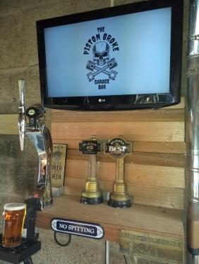

The side project has had a wee update 😁
Welcome to The Piston Broke Garage Bar 🍺
Looks excellent
How did you do that on screen?
And the no spitting sign is excellent 😀
The TV is hooked up to an old laptop just for now, until the next phase of 'Project Piston Broke' and is just the background picture. I found the skull and pistons image on the internet and found the software to place the text around it.
It's a bit clunky, but I can play YouTube and my music through it for now. I do have plans for a touchscreen jukebox/YouTube player type thing but I'm still gathering the parts.
I can't remember where I found the No Spitting sign, probably in a skip 😀 but the brass match scratcher next to it came from the pub in Aberdeen that I worked in 30 odd years ago.
