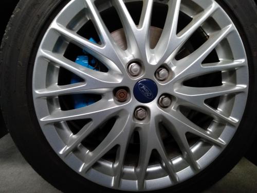

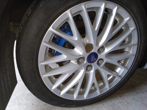

So I decided to add a splash of colour to my brake calipers and went ahead and order this:
Quote
My choice of colour was Blue, my reasoning was; when I first got into the car for a test drive I was hit by the blue vibe coming from the center console. Another reason is that the RS has blue brake calipers so I felt a certain pedigree.

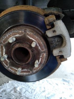

At this point I've only done the front brake calipers, I need to buy a replacement paint brush and every where around here is closed on a Sunday and I'm not driving 140KM to go and buy one! I'll get one during next week and do the rear calipers next weekend.
For anyone else thinking about doing this modification, it is really straight forward and the destruction's pretty much cover everything, as with all forms of painting, preparation is key. I got myself a set of wire brushes specifically for this.

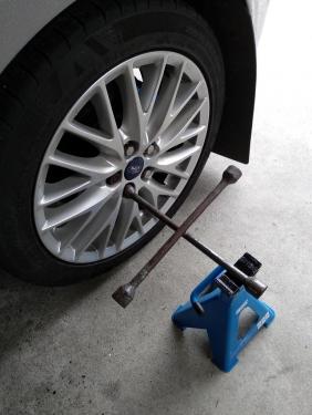

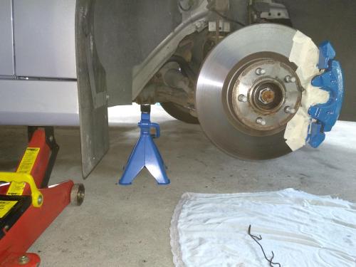

One handy thing that I will point out is a good location for your axle stands to go, as pictured.
A few more pictures.

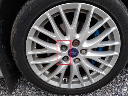

One thing I did notice when putting the wheels back on was these little wheel nut caps keep popping off, looks like I'm going to need to buy a few as replacements for the future when I notice that I've lost any..

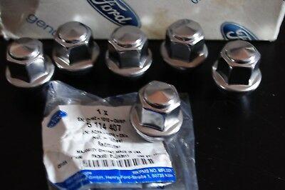

On a side note, two of those blasted wheel nut caps have came off whilst on the road so I'm thinking about buying these:
Quote
I presume they'll fit (referring to the Masters of the forum!!!)

I guess what I'm trying to ask is.. are these the correct size? M12 x 1.5 19mm
I'm pretty sure they are but I just want to double check with the more knowledgeable on here.. i.e. you Wes!!
I know nothing about cars in general lol, just my own personal experiences.
On Ford Parts UK there are two different types of nut listed and bizarrely neither fits yours or my car according to the fitment dates. The two types listed look visually different from the front and I'm sure the tapers on the rear differ too.
https://www.fordpartsuk.com/alloy-wheel-nut-1222
https://www.fordpartsuk.com/alloy-wheel-nut-1223
If no one else answers then I would ring you local Ford parts department for a definitive answer on the correct part number. Other than that nip down to a local breakers yard if you're near any and get a few off another Focus that you can see are the same.
I reckon there is a typo error on the second link fitment details I posted but I could be wrong.
Edit - I didn't look at your link sorry and  wrongly assumed you were buying genuine Ford replacements!
Cheers Wes, I'll look into this again in a while when I'm not rushing and maybe somebody else will have some input in the mean time. Thanks again
Hi Rob, I was having the same issue as you regarding the caps coming off the nuts.
I'm 95% sure that's the size I ordered for my MK2.5 Zetec S, it's roughly what I payed for them to. I'll have a look on my eBay history to see if I can find the purchase and get back to you.
I've just checked the nut is M12 x 1.5 and the Ford part number is 1678260
You are my hero! Great stuff, thanks Wilto
EDIT : I Presume Mk2's are the same as Mk3's?
EDIT, EDIT : A very quick reply from the eBay vendor and he say's they'll fit, ordered.

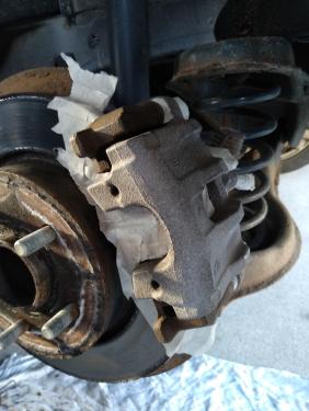

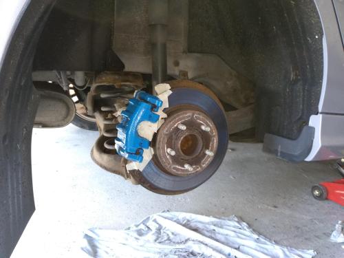

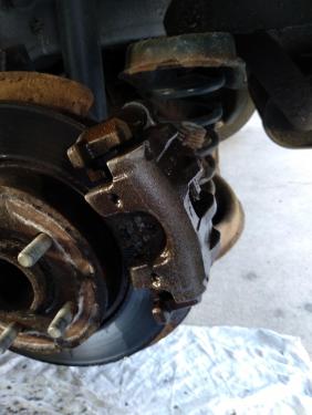

I've been doing bits and bobs on the car today, I started off finishing  the brake caliper painting (I hadn't painted the rears last weekend) so here's a few pictures of what's involved.. It's really child's play but if you've never done this then at least you can see what's involved.
Caliper wire brushed.
Caliper spray cleaner (provided) then wiped down with an old rag.
Caliper masked up.

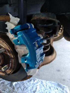

Caliper 1st coat of paint
Calipers 2nd coat of paint (I haven't finished the passenger side yet, so this is the drivers side)
Masking tape removed and wheel refitted.

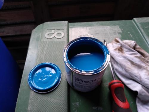

I also wanted to show you how much paint is left over after painting four calipers, a hell of a lot (as you can see, I haven't even used a fifth of the paint pot)

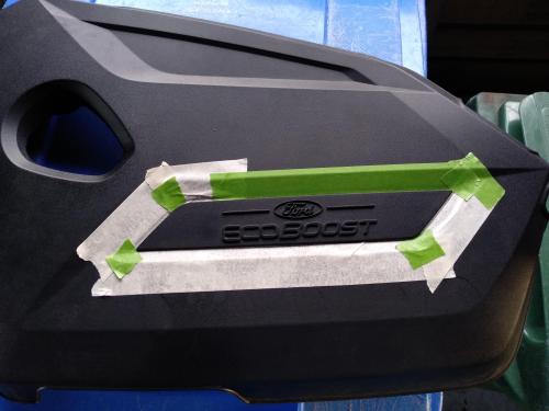

Hmm.. what else could I paint? I don't want to go mad painting everything but something subtle? Here's an idea..
I'd spray it silver then inject the blue in to the ford badge using a printer cartridge refill syringe,
Mask up everything after than then sand off the masking tape from the "EcoBoost" and spray black. Done it on my 1.6TDCi

Yes that would be indeed a nice touch, unfortunately I've just painted the whole thing Blue! I'll see how it looks once it's had a second coat and then maybe I'll add some detailing.
I've got a shed load of paint left though!

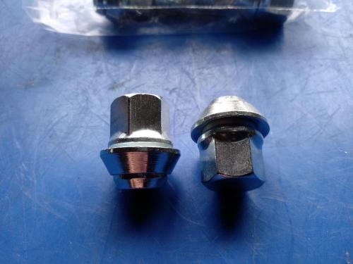

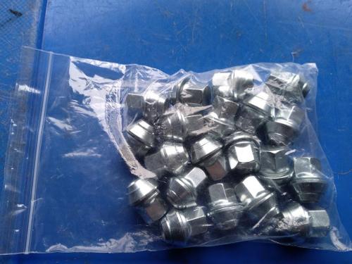

OK, so for today's Friday Fun!
Here's a big bag of my new nuts..
A a close up on a pair of my nuts.. oo-er!

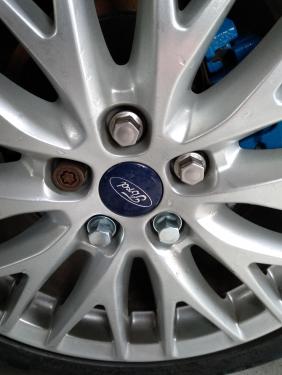

Why change my nuts? Here's why..
Here's a cracking tip for you:
New vs Old..
Never again will this happen to me.. yay!
