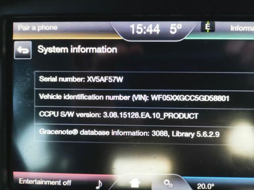

Ive read just about every post on internet about enabling Sat Nav on my sync 2 head set. I think i have all information/hardware and files ready. But before i attempt i wanted to just get a little help from @Bannko . Im in the UK, I own Focus 2016. currently have firmware version 3.08 on unit. I have D/L NaviPtach.png plus navapp.zip which is about 27mb and contains SyncMyRide folder plus a autoinstall.lst file.
I also have Gen2v310EUlanguagepack5 which is about 716mb and of course i have my  cabled and switched ELM327 with Extended Forscan.
Does this all sound correct. After reading post on here is there a difference between what i am going to attempt and a paid licence from another website.
Image below of my sync2 version number.
Any help or warning much appreciated.
Many Thanks.
P.s i Have a Purchased  F8 maps on SDcard
@WilB0 you are prepared well pal, just in your case be careful while installing additional packages, to avoid any further errors or problems, please install ONLY the update package 3.10 that you have prepared, PM'd you more details.
