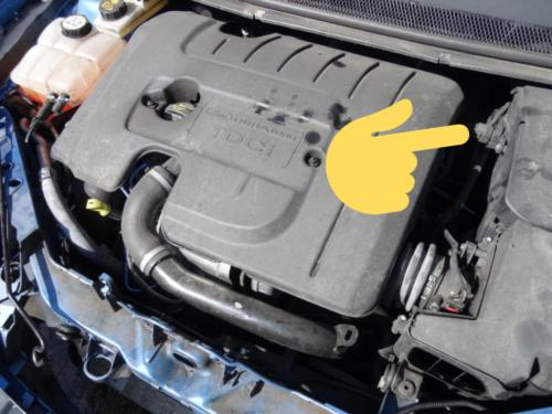

A common problem is a leaking injector which can cause blue smoke on start up because the injector seal is passing 24/7 it fills the cylinder when the engine is off; this then gets chucked when the engine is operating causing blue smoke,
Of there are wires going to a small box which would be fitted to the side of the battery box then it has a dpf.
If theres no small box with two cables attached to the left side of the battery box then there is no dpf,
