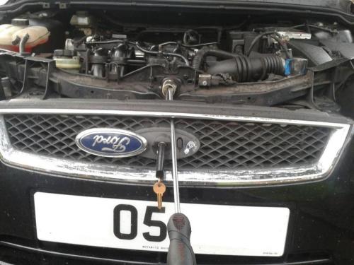

AndyO Posted November 16, 2017 Share Posted November 16, 2017 Adding my own experiences to this topic: On my 2007 Focus ST - the bonnet lock deteriorated very quickly, I was able to open it twice by first pushing down & using just the key, after that it would not open when I turned the key right. A long screw driver did not work for me - spent around 2 hrs trying, then went under the car. I damaged the mechanism when I finally got it off, it's not clear what had gone wrong but a new cable etc. works fine. If all else fails, take some time to read all the posts in this thread - I'll not repeat but everything required is there. Get a long, thin, 30cm screwdriver - £5 even at expensive shops. It took me about an hour under the car, and another 20 mins jacking up & placing axle stands etc - not as bad as I'd feared. You will need a 10mm spanner (preferably with an angle for the ring end), a good torch / light (I used an off-road bike light - this helped), small hands if possile and a bit of patience to reach and undo the two bolts / screws on the back of the bonnet catch. Take your time, you may not be able to see one of them until you've got it partially undone by touch. When you have them both removed, ideally you need to prise the catch towards the back of the car - do what you can from underneath the car, you may be able to poke a long screwdriver throught the grill if like myself you had the first stage of the bonnet unlocked. the fitting has a few ferrules that ensure it is sitting in the correct location - these disengage by moving the catch mechanism back about 5mm. Then just give the bonnet some force up, careful not to lift too high due to the alarm sensor cable. When the bonnet lifts, you should be able to then access the latch and operate it manually (with a flat head screwdriver) to seperate from the bonnet & sort out the cable etc. Fitting the new kit: I was able to retreive the old lock by a combination of knocking out & drilling out the metal 'rolls' that hold the lock mechanism together. 2mm bit, possibly a 2.5mm bit, I had to prise apart using some flat screw drivers after one of the rolls / rods was partially left in, this was possible as it had been weakened by the drilling. Re-assembly of everything was straightforward, as earlier people have suggested it's worth removing the screws for the front grill before you close the bonnet for the first time - it may give you options should something go wrong. Quote Link to comment Share on other sites More sharing options...
dave.j Posted February 12, 2018 Share Posted February 12, 2018 (edited) 5 years on and this problem still arises , except now we could be talking about a 400 quid banger. Brigante - you were lucky. And the photos don't show anymore ?? Easiest and Quickest method if bonnet opens partly with left turn of key - Remove lower watershield -8 torx screws all easy. Reach up and pull lock IN , may have to bend 2 clips back. Using sharp wood chisel from front of partly just open bonnet cut heads off the 6 visible PLASTIC screws holding the grill in place - use a hammer. Remove grill by pushing back at bottom to unhook and then whole lot forewards. Using wood chisel through the grill space smash all white plastic away from bonnet catch. , remove white cross section bit - pliers . You can now use a screwdriver to open bonnet. When grill is replaced , use extra self tappers if you like ,you will need a longer screwdriver or bar but you will know what is what by now. Edited February 12, 2018 by dave.j spelling 1 Quote Link to comment Share on other sites More sharing options...

Ennvoqation Posted May 8, 2019 Share Posted May 8, 2019 Yes, but I ended up boring out the lock and then pulled out the whole assembly out and then applied day glow paint to the slot that operates the catch. I then got some to make me a T-Bar that could rotate the catch so I could open the bonnet. The paint was to show where the hole was with a torch as it's a pain to insert otherwise. It's been amusing to see a mechanics face when I give him the bar. Probably one of the worst lock designs I've ever seen on a car. Quote Link to comment Share on other sites More sharing options...

robby12345 Posted July 5, 2019 Share Posted July 5, 2019 (edited) Hi, My 2006 Ford Focus hatchback 1600 petrol Can you please answer two questions for me.? 1/ With Grill still in Place, and Bonnet Closed, unable to Open.how do I Guide my Long Screw Driver to Press the Collet, whilst Turning Key Left them Right .? 2/ Is it Wise to Remove Grill by Snapping the 4 plastic Grill Screws with a Chisel Making it Easier to Access the **Broken Bonnet Lock** on my 2006 Ford Focus Edited July 5, 2019 by robby12345 Quote Link to comment Share on other sites More sharing options...

MostlyVolvos Posted December 14, 2019 Share Posted December 14, 2019 Just joined up to say thanks to the posters in this thread. I was sorting this issue for a friend & the info here was really helpful. This one didn't respond to the 'screwdriver through the grille' method, so I had to remove the panel underneath & reach up between the rad & grille (ouch!) to (eventually) force it to open. It turned out the cable had snapped *and* the plastic cross at the top had disengaged. It's such a poor design, it lets down what is otherwise a pretty good car. I really think Ford should've fixed it with a recall, since being unable to perform basic maintenance has implications for safety... Anyway, cheers guys! Quote Link to comment Share on other sites More sharing options...

Bar72 Posted August 13, 2023 Share Posted August 13, 2023 Still happening in 2023! Google search brought me here so I'd like to extend many thanks to OP for posting this guide. Removed grill to replace front wing and bonnet wouldn't open after closing it. After pushing in the mechanism with screwdriver got it open then just smashed away all the white plastic around the mech. Ordered the upgrade for Ford Part No: 4549268 on eBay, which is slightly longer, so I can now remove grill, letting the lock barrel hang free, without it disconnecting from the latch now. Here's the eBay number at time of posting: 283777867648 Quote Link to comment Share on other sites More sharing options...
StephenFord Posted August 13, 2023 Share Posted August 13, 2023 18 minutes ago, Bar72 said: Still happening in 2023! Google search brought me here so I'd like to extend many thanks to OP for posting this guide. Removed grill to replace front wing and bonnet wouldn't open after closing it. After pushing in the mechanism with screwdriver got it open then just smashed away all the white plastic around the mech. Ordered the upgrade for Ford Part No: 4549268 on ebay, which is slightly longer, so I can now remove grill, letting the lock barrel hang free, without it disconnecting from the latch now. Here's the ebay number at time of posting: 283777867648 I'm on my 4th 'lock', now I bought one of those extenders, but on replacement installation, forgot to put it in LOL Sshhh... worked for 2 years now without it. 3 Quote Link to comment Share on other sites More sharing options...
