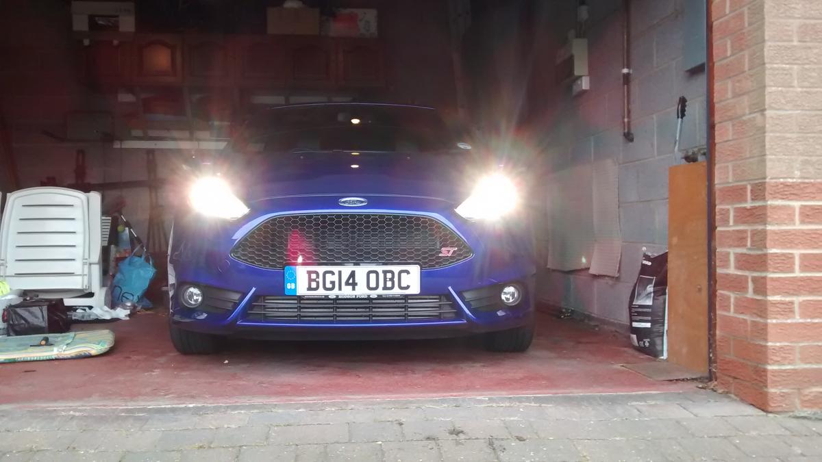

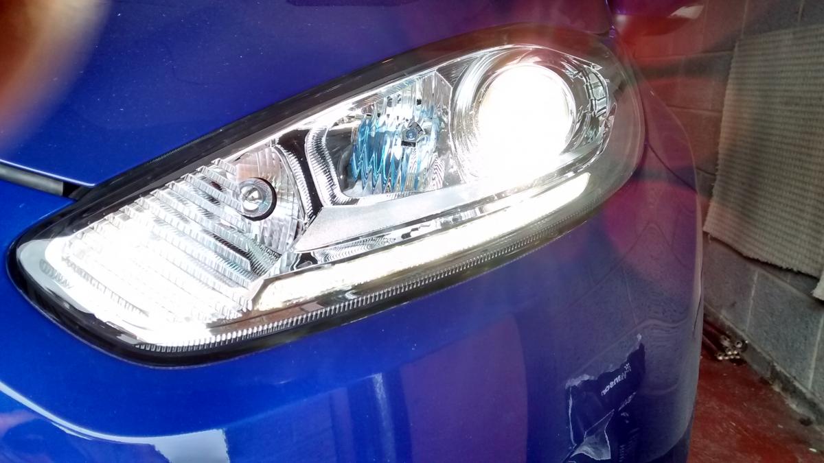

Mine are here :)
Sent from my Nokia 3310 using Ford OC
And there in was bored so used the iPhone torch and did them in the dark hardest parts I found we're
1. The nut under carpet for back lights didn't realise till saw something phil1f put on
2. Getting the wing mirrors off.
Other than that pretty easy :)
This is the comparison hard to do pic tho with lights.

Same as the bulbs I did today except the H7s and those funky looking LEDs, and I didn't bother even attempting the wing mirrors after others have said how hard they are. What's the easiest way to do them? I might ask Ford to do them for me on Monday when it goes in for its oil change.
I guess in the dark you can't see how good the chromed indicator bulbs look:
It would be good to get the cars side-by-side to see if the extra 100k of your H7s is noticable. Also need to get the fogs done, they look really yellow in comparison.
Edit: have you gone for a drive to test them? The full beams are awesome :)

I went for a drive and they are loads better main beam shines for miles and the h7 leave a nice crisp white road surface.
