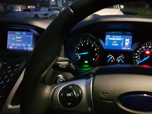

I did what JW said and started lower to make sure it converted ok and below what I needed to get to, although I originally wrote the wrong millage on my previous post, so had to plug the old unit back in to get the right millage so I didn't :censored: it up... lol
 Managed to get it sorted and I'm happy with the fresh look... thanx guys yet again
