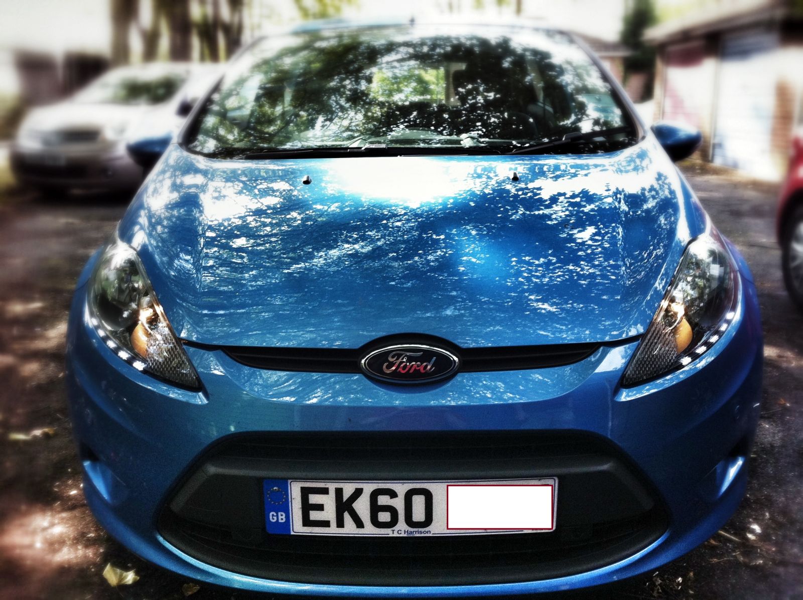

as promised^^^^!!!! my sidelight has gone rather annoyingly, before i fitted these it only worked when it wanted too though... but i think it looks the sheeet!!!!!
and with this guide saying you bought the cable lock connectors things from halfords, did you not notice that bang next too them was electrical tape?! haha
looking good, i'd deffernatly recommend led sidelights and either philips diamond vision or halfords ultra blue(the ones i have) for the dipped beam to get rid of the yellow.
i just fitted the bright white bulbs i was using in the boot so i could actually see in there when its dark lol and the healights are new xenon ones
much better than the horrible yellow ones :D
