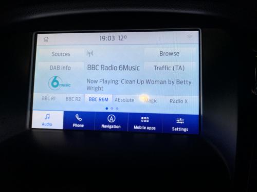

I’ve made some progress!
got rid of the climate and enabled radio station icons.
however I’m still having the issues with the voice control, and I used the 4u5t voice file so don’t think that’s the issue. I’m on 19101 for some reason though and not 19200
also the installation in progress still popping up when I start?

Sorted out my brightness issue, just need to enable calmscreen and the station icons.
Like 3.4 very much.

I’ve got the clam screen and logos working but only when you change the asbuilt without rebooting the unit, the option goes as soon as you turn the unit off. I think a firmware update is needed to keep them. I’m going for a walk with the kids but will have a go later on, hoping it might sort the installation in progress issue as well. The voice commands for the nav I’m not to fussed about fixing 👍🏻
That's odd. @Tezza Are your calm screen and radio logos permanent?
Yes they are as i was hoping someone would found away to do this without updating to MY2018.5 software so it looks like it has to be done
