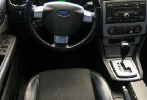

I have a mk2 ford focus 07, it has an automatic transmission and I would like to know the model name.
Is it powershift? Duratec? Is it dual clutch or torque Converter?I have attached a picture of the gear lever.
Additionally, how reliable are these transmissions?
Many thanks.
No snazzy name for this one lol, just 4F27E.  It's a conventional torque converter auto.
Seem to be reliable, just not very good on fuel.  Much more reliable than the later Powershifts though!
As above, just keep the fluid clean and it'll go forever

I have the 2006 2ltr auto and I am at 140,000  still run smooth I have done a fluid change but apart from that, it changes great this is my third focus auto first 2 where 1.6 ltr and did above above 200,000 with no issues
Out of interest, is there a reason why it is a LHD version?
I wonder if the Op just lifted a pic off of the internet rather than going out to his car to take a pic (I guess all will be revealed shortly!) 😀
