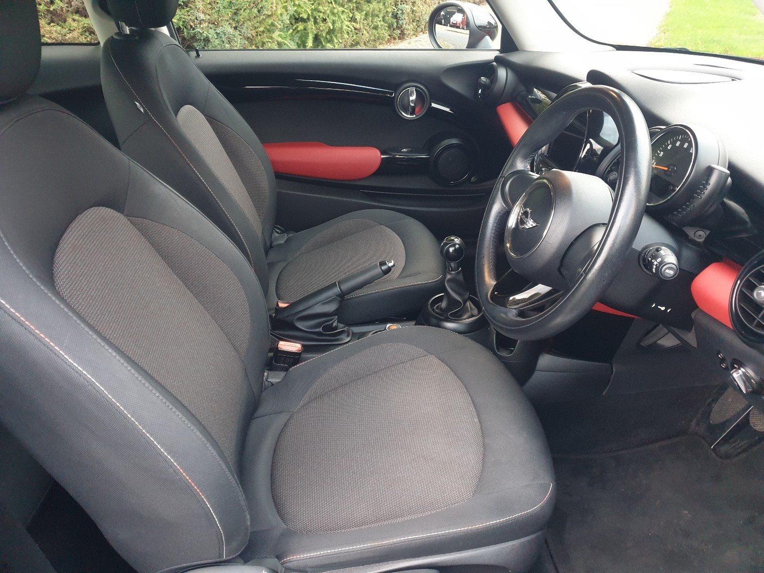

You can still unlock and start the car with a flat key battery, at least on Fords and most others. Would be a massive oversight on BMW not to be doing the same for the Mini.
You just have to hold the fob against the steering cowling on the Mini.  There's a key symbol to show exactly where.
