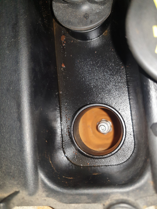

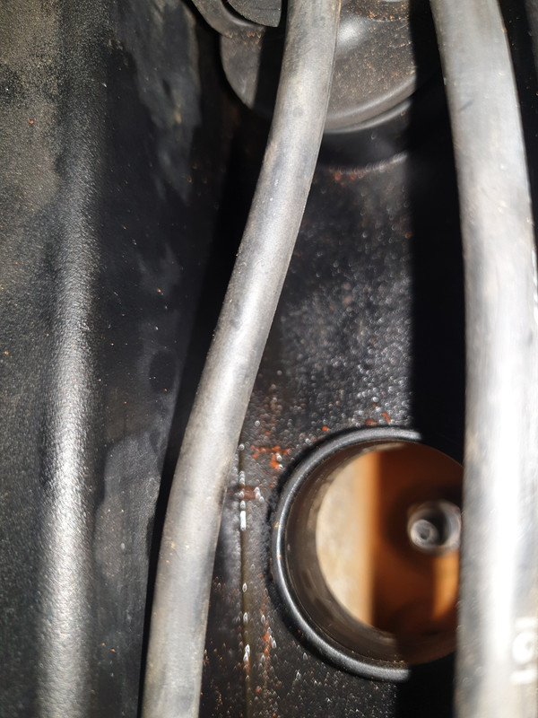

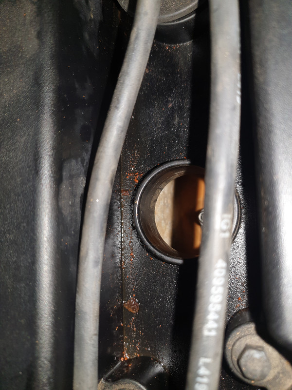

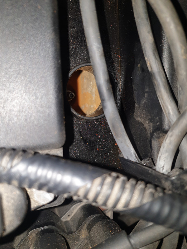

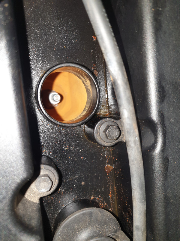

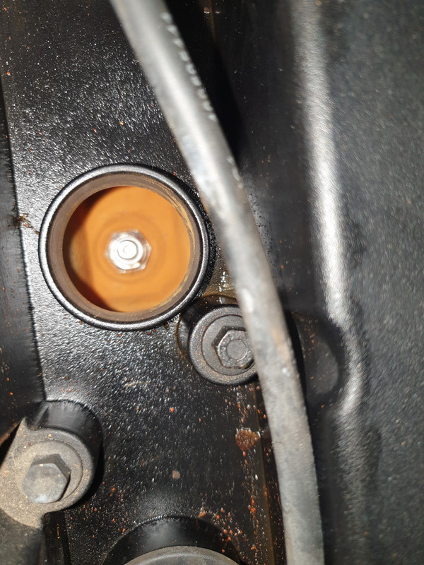

that guys sparkplug cavity looks just like mine with the orange rust, he seem to be still driving it and not cleaning it.

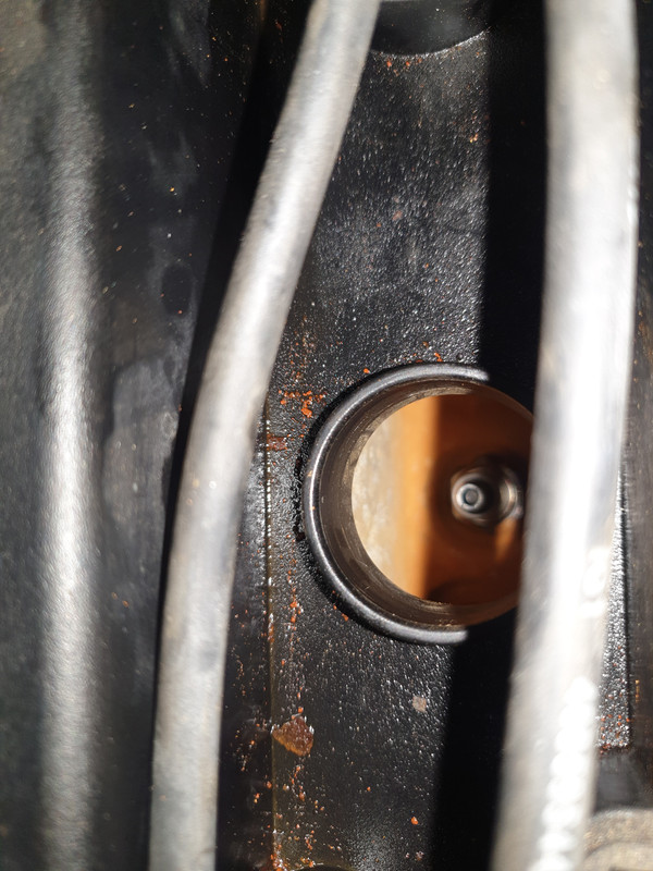

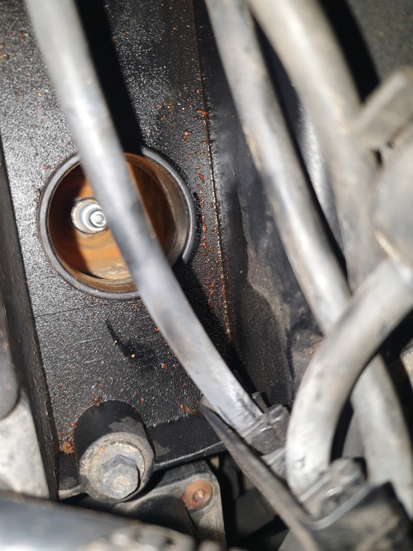

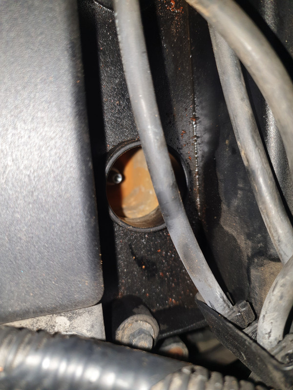

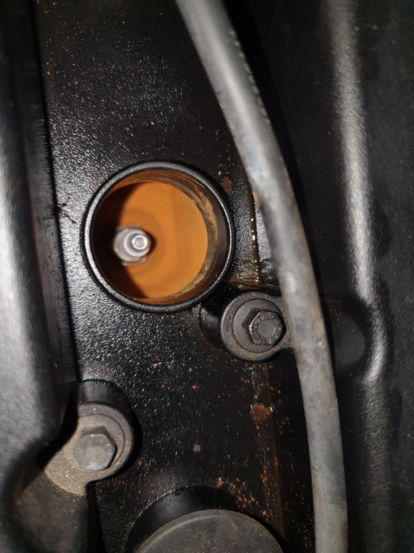

i have took pictures of all my sparkplug in the engine, see how much rust i have got:
i have took these photos after about 5 hours of driving in the rain ( been raining non-stop) and even used my jet wash. not a drop of water was in the sparkplug cavity and no water on the sparkplugs too which tells me that maybe someone washed the engine out to make it look clean and water somehow got in the cavity.
as you can see, my cavity looks identical to the guys on the video.
Yes, it's really not terribly difficult. I'm sure you can manage. 🙂
We can only speculate as to how the water got in there, but it's great that it seems to not be a current problem.
Indeed the guy in the video also has the same problem, and his looks to be in even worse condition (look at the rusty mess at the bottom of the wells at 5:49). I wouldn't assume though from this video that he's not done something about it since, or has even given any thought to it, and just because it drives okay I wouldn't just dismiss the idea of addressing it.
Remember that such red/orange rust specifically is a product of oxidation of iron. There are two sources of iron in those wells for you to be concerned about, the steel portions of the spark plugs, and also the "core plugs" that sit in between them (the engine block is aluminium as I'm sure you know). "Core plugs" are steel "caps" that are wedged into some holes in the engine block left over from the casting process (cavities like coolant passages are filled with sand at some stage of casting and this sand later needs removing, hence the holes that need to be plugged up). The core plugs that sit in between the spark plugs are plugging holes that lead into the coolant passages I believe. If those core plugs get too badly rusted then flakes of rust could fall into the coolant passages, with the potential for this to clog up small passages such as those in the radiator. Also, if a hole forms allowing air to flow, then the coolant system may not be able to hold its normal higher-than-atmospheric pressure when hot, which will affect the performance of the cooling system (the rubber parts of the spark plug coils might not provide a good enough seal to prevent such air flow out of those wells). I suggest that it would be a good idea to inspect these plugs. If their condition is not so bad then you could either just leave them be or give them a little clean (they're not going to get worse unless exposed to more water). If they're bad enough to need replacing (like those in that video probably are), then this isn't particularly difficult. Core plug replacement involves (from having seen a mechanic do it on some youtube video a while ago), carefully piercing a screwdriver (or similar) into the cap and prising it out (being careful to not damage the engine block), then, using a socket of a similar diameter, gently and evenly hammering the socket to drive the new plug into place. (A flush may then be wise to try to get rid of any flakes in the coolant).
With respect to rust in the spark plug threads, one reason for wanting to remove it might be a concern for it clogging up the threads a bit, but there's also another possible concern - the clean flow of electricity. As I understand it, the electricity flowing into the spark plug from the HT lead, returns through the aluminium engine block itself. I would suggest that rust between the mating surfaces of the spark plug and engine block could inhibit this flow of electricity to some degree.
I would not be concerned at all with the light rust deposit on the surface of the well. Clean it or leave it, no matter.
So long as the condition of things isn't too bad though, it may be perfectly reasonable for you to consider taking action to not be worth the bother.
