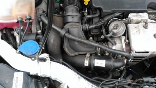

iantt Posted December 13, 2018 Share Posted December 13, 2018 Job for today. My turn to replace degas hose for MK3.5 ones 1 Quote Link to comment Share on other sites More sharing options...
iantt Posted December 13, 2018 Share Posted December 13, 2018 Took all of 10 mins 1 Quote Link to comment Share on other sites More sharing options...
