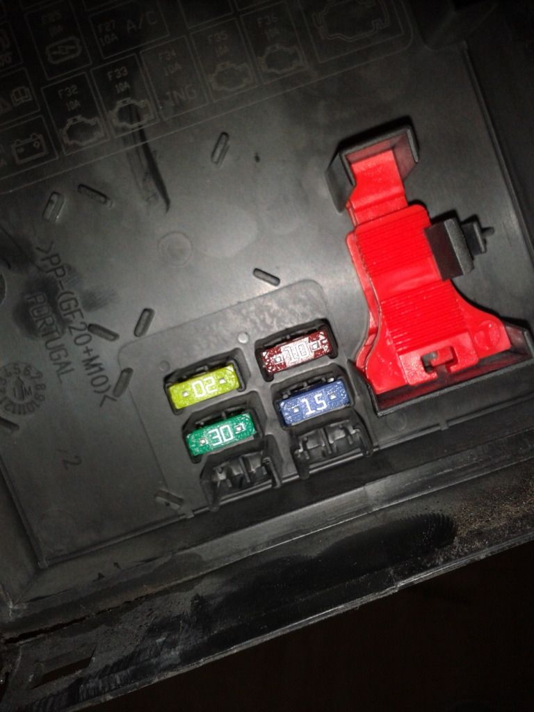

Just a quick thought, have you checked if you have any spare fuses in your fuse box lid under your bonnet?
Clive knows the right runnaround I had when trying to find a garage at night that sold mini blade fuses after one of my 10 amps blew.
Then not long after I found out I had spares under me bonnet the whole time:
Clive thanks a ton, cleared it up for me. Brigante i know for sure i haven't got any spares but thanks for that. I didn't even realise this myself until i bought some new fuses when i first got my car. Little smart way put them.
