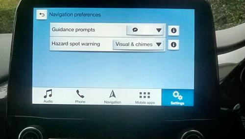

You can actually set the built in nav on the MK8 Fiesta to alert you to fixed speed cameras.  It has an audible alert of 'Caution !' and it also shows the the location on the map with a red triangle exclamation mark (if I remember correctly).
I have no idea how up to date that information is and I think systems like Waze will always be far superior, but the built in sat-nav is always running in the background so it could be handy.
I've never actually managed to find that! Which menu is it in?

Hi Roger.  It's Settings, Navigation, Navigation Preferences, Hazzard spot warning (see picture):
Thanks Gary, much appreciated - hope I didn't cause you to go out in the cold!
Lol once I read your post and popped out to the car I realised I did already have it set! Didn't know it covered camera locations though!😀

So what you're saying is that I braved some mild drizzle, along with the need to put a medium thickness jumper on (well hoodie) and go out there for nothing !?
Nps m8 🤣  Yeah I think they deliberately obfuscated the description, although I've read that it does include 'other' hazards too.
