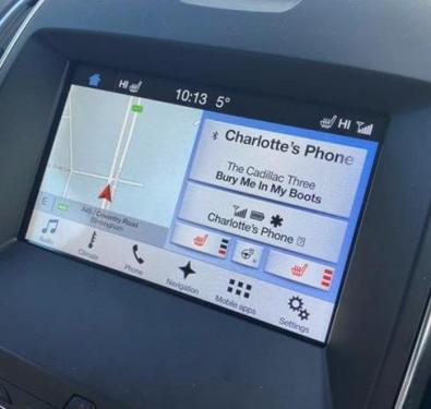

So what version of Sync is in this photo ?  Im presuming not all models of vehical show the same info, as mine does not have climate control or show the heated seat icons, and this was taken in the UK
This is either 3.0 or 3.3.
The software buttons for climate/seats is just a config switch.
So does that need forscan or the like to enable these
Not sure if it works with the MK4 yet, but on older models it can.
