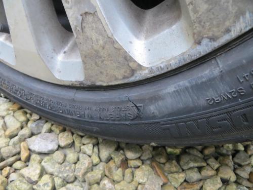

Have just 2 weeks ago replaced a nearside front budget tyre   205/50r17  due  to  tyre wall damage ..gash/tear
and just 2 WEEKS LATER  the same has happened to the new budget tyre .
I cannot beleive it and have been driving for 45 years
and have been driving focus'  for  5 years .Have not had this problem on any other wheel .
the parking is very congested  and difficult to find  in this city  but although i sometimes do catch the kerb slightly , not severely enough to cause this .
my judgement is a bit out  on focus' , probably due  to   the fluted wings.
the budget tyre was a Landsail
any one else have this prob ..or is it  me ? 😕😕

wow  sorry for late reply , have reluctantly come to the conclusion that's it's  my  lousy driving ! Because  the wings are fluted  it's harder to judge
the distance to the kerb , the roads are so narrow  and packed where i live  that you can hardly squeeze past  those big(tanks )4 x 4  jobs that  many like to clog  the roads with nowadays ,when they are coming in the opposite direction . I have changed the tyre  and .............nooooooooooooo , knocked a chip out of the replacement  .
I've been driving for  46 years...44  of which i have never had this problem . It' a real  come uppance . 🤪
the alloys  were  marked like that  when i bought the car , that's a seperate issue .
if you pull that flap of rubber back, can you see the reinforcement strands of the tyre? if so, that's not good
I'm getting experienced at knackering my tyres , it's always  the nearside front  btw  , the previous two have been even worse than this  one 😧
and yet  when i go to a tyre  place (and they want to sell you tyres) they say  it's still legal and ok to use .
if it's not bulging there and it has not gone as deep as the reinforcement threads/fibres/strands it is OK
I've also done this quite recently on a new tyre that was fitted for just a couple of weeks. After checking that it hadn't gone down to the reinforcement and wasn't bulging I just glued it back using impact adhesive. It's been fine since and I can't now see the repair.
