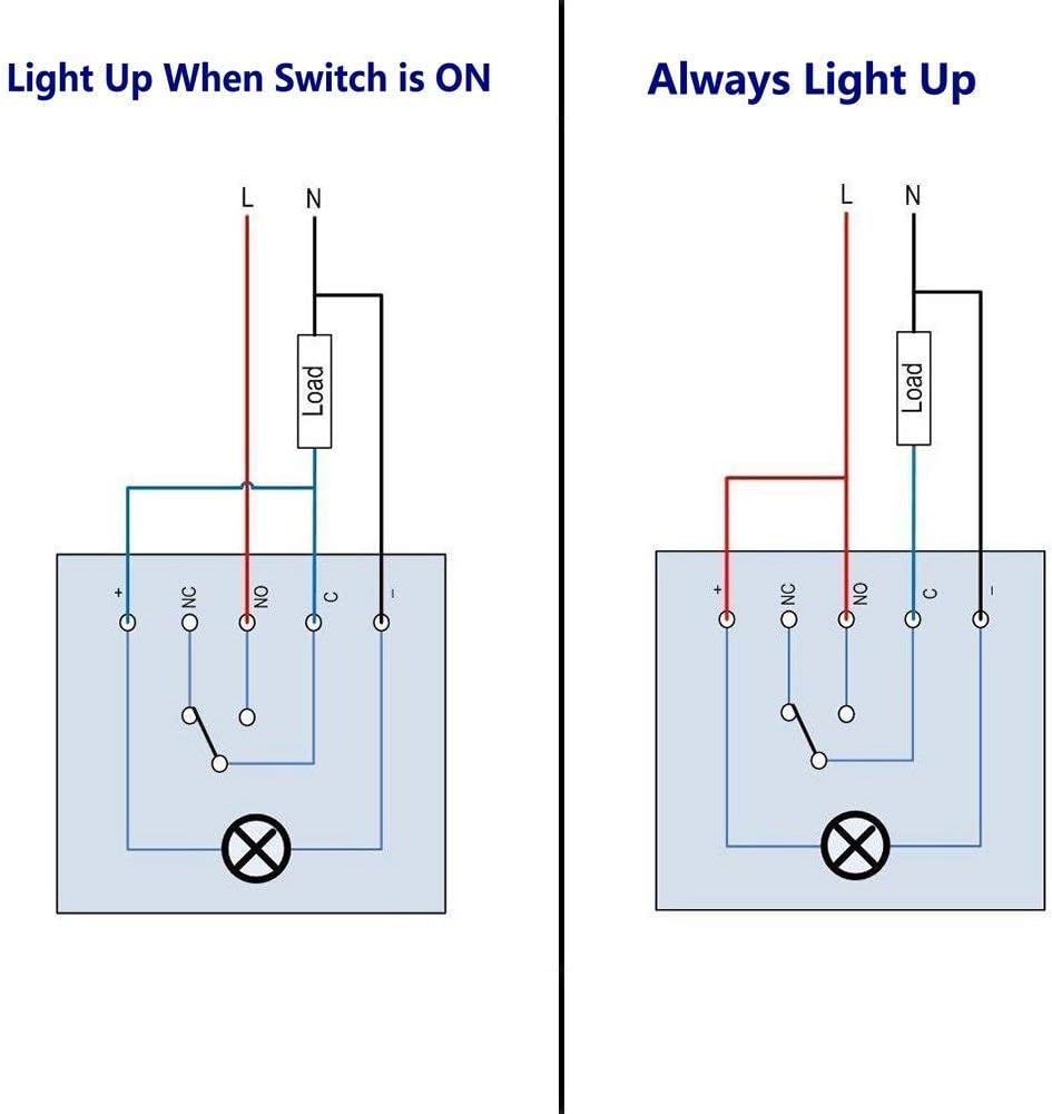

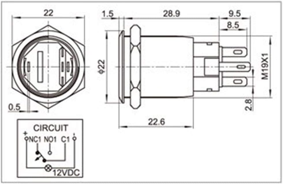

So, I've purchased this 12v momentary switch: https://www.amazon.co.uk/gp/product/B07GLPBPPZ/ref=ppx_yo_dt_b_asin_title_o00_s00?ie=UTF8&psc=1 and plan to mount it in the car someplace.
I have 3 wires from the car -
  • Central locking LED status indicator (originally from FCIM 2)
  • Door lock/unlock signal (originally from FCIM 6)
  • Ground (spliced from from FCIM 5)
What I want is to wire the door lock/unlock signal to the button press and the central locking LED status indicator wire to the LED light on the switch so that it's only on when the car is locked. On the old radio fascia, I presume it just sends power down the central locking LED status indicator when the car is locked...
I also have a ground wire.
Can anyone confirm the pin out?
Yep. You want to connect the ground wire to  common and also led neutral. Door lock signal to "NO" and the central locking LED to the LED live.
The signal works by making contact with the ground.
Is common definitely to ground and not live? Is this so no 12v signal is pushed down the wire when you press the button?
Yeah I'm pretty sure the switch works by the switch wire picking up the ground. This is the case with the HRS, the stop start and parking switches.
It probably saves running a live out to each switch, as the ground is mostly there already for the illumination.
