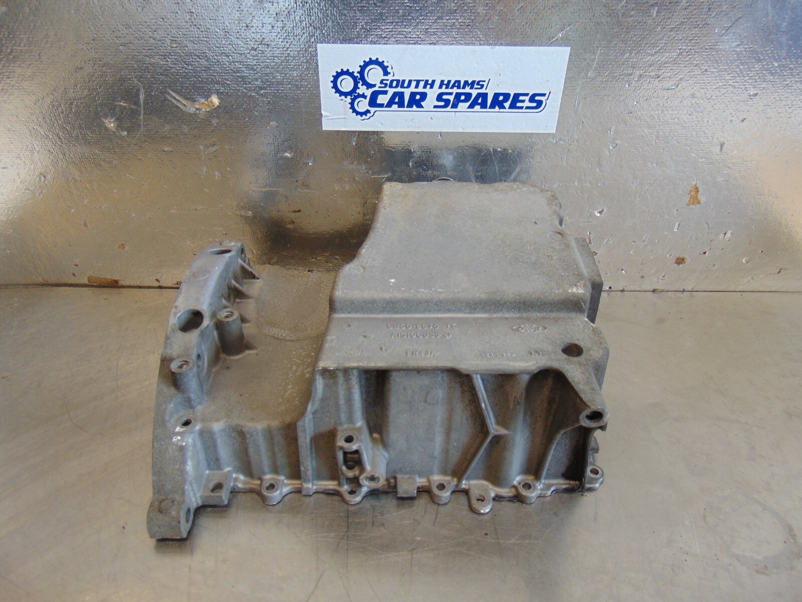

Which part are you prying?  You will need to remove those 3 bellhousing bolts that go sideways through the sump.
Lets stop for a moment. The pump needs to be detached from the sump or there will be other work to do.
It looks as though you haven't dropped the exhaust down pipe. On a Focus I know it's not possible to manoeuvre the sump out or back in with it in place. The Fiesta is likely to be the same.
You've exposed the broken bolt nicely. Why not just saw it through somewhere near the pump. That will let you get it detached and the give you the possibility of removing the broken bolt from the sump later.
One you have removed all the bolts around the sump and the two bigger diameter ones into the gearbox, the pry location is a small slot you will see between the gearbox and sump at bottom dead centre.
Insert a large flat bladed screwdriver into the slot, push it in firmly - and at the same time push the handle of the screwdriver towards the gearbox side. The sump should then release.

Done that dropped the sump but can’t get bolts off the exhaust or take the or sensor out as it’s completely messed and now it’s stopping me once again.
Done that too but not sawed it I just smacked it a few more times 🤣 and it fell off.

Finally with some persuasion of the exhaust I got it off 🤪 had to remove a clamp in the middle of the exhaust and that gave me a bit more room to play with lots of belt in there plus 2 teeth off the belt 😬
ps. I already removed all the gunk from the pump prior to the pics
That is not good news. With teeth off the belt it will require replacement.
Although you can do a thorough job clearing up that mess, in order to replace the oil pump belt it's necessary to do a shed load more work (the same needed to replace the cambelt).
Well done for persevering and getting the sump off.
Though in technical terms, that's dead I'm afraid. :sad:
You can't drive it with teeth missing.
I'd contact the finance company again to see if they can offer any help.
Reckon that’s why it’s just come on the oil light? Or maybe it’s been like that some time?

I reckon the teeth came off after the turbo change.  Belts probably got a little dry & stiff while it was off the road then running it again was the final straw.  But the belt has been degrading for a while looking at the state of that oil.
There's no need to seal the 'half moon' against the gearbox bell housing.
