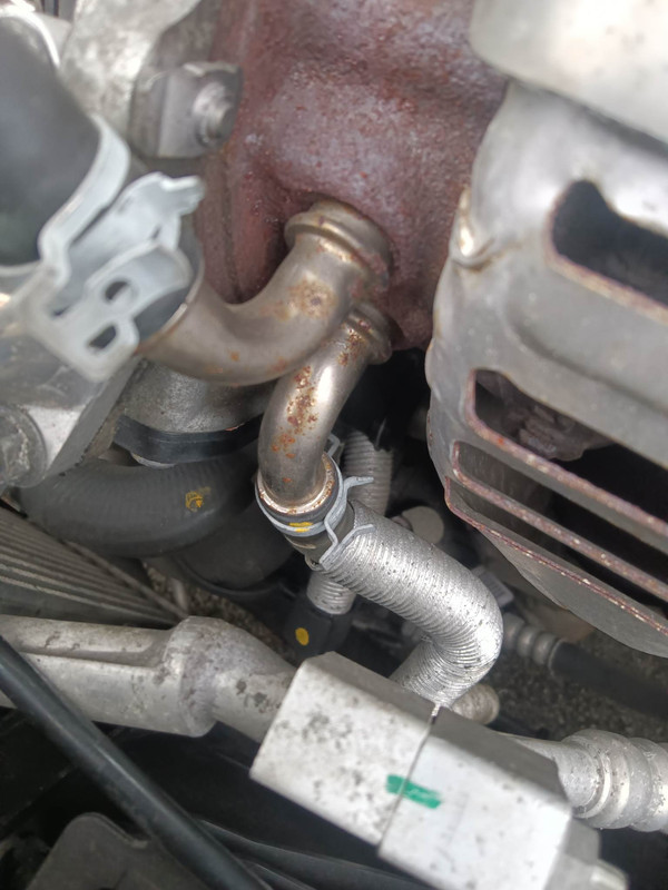

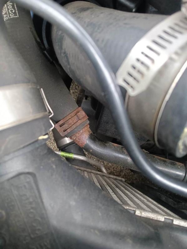

Hi everyone, Hope it's not too late to revamp this thread haha. i’ve been reading through all the posts both here and different other platforms like the facebook group for failed ecoboosts. I recently acquired a 2013 (65k on the clock) 125hp petrol ecoboost titanium. Full stamps in service book (only a few at Ford though) and history. Driving yesterday, somewhat in traffic I saw the engine temp was up and went 1 bar above the limit, then came down with start/stop (i’m guessing?). Checked today and the coolant level was below minimum and can’t remember if i got the car like that but I’ve driven a good 400 miles already with no issues. In 2021 previous owner changed the expansion tank, water hose and turbo pipe (at a garage), guessing it still had the sh*t ones Ford fitted.
My concern is why has the coolant level dropped so much? I couldn’t see any obvious leak spots but haven’t checked the area under the clutch to see if the heating matrix (?) is leaking.
I can also see I have the mentioned rust spots on my turbo pipes and not sure if this is a rub down and paint situation or it’s too far gone and I should try to force Ford CRC to get this changed for free (lol free, right...) I thought the leak culprit could be the rusty spot on my coolant pipe joint?
Could something like this be the culprit for a leak?
The rust on turbo pipes.
I wonder if this topic holds the record for the longest thread 🙂
The corrosion on the pipes shown is minor. The pipes themselves are substantial (see pics).
Never heard of one leaking/failing - most 1.0 Ecoboost engines/turbos fail well before these pipes would ever be an issue!
As previous posters have said, the surface rust can be removed using abrasive paper/cloth and protected with a suitable high temperature enamel. Personally I would only do it for cosmetic reasons, not for fear of failure.
Edit: Forgot to say, get the coolant loss issue investigated soonest. The head gasket may already be failing but to drive it in that condition, with the temp gauge shouting too hot, could lead to a massive bill.
And - unless it's already been done - the car is due for a cambelt change which is very expensive on these engines.
