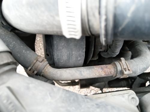

I’m from Dorset but live in Bristol for uni and have it booked in but £120 for diagnosis so may buy a diagnostic but presumably this would not be good enough if I want ford to cover the costs I’d imagine they would need to diagnose
picture attached
The pipes are rusty but I can’t see a possible leak point. If you haven’t had the car serviced for a while you could always use the £120 towards the service. This will tell you if there is issues but at least you will get something for your cash and it may even solve the issue. If you have any reasons which cause overheating in the turbo it will power down to try and prevent damage. There could be many reasons  for this such as low oil pressure because your filter is gunked up, poor water pressure or software issues preventing the turbo running correctly. I think a service will show up any faults. Just remember that in the Ecoboost the turbo runs constantly. It doesn’t kick in at certain revs - it has to run all the time to provide the torque needed. It has an ‘overboost’ feature which can boost at higher revs and this may be what you are missing. This overboost is the cause of many overheating problems so your software may be limiting it.  I hope you get it sorted easily.
Those pipes look pretty rusty and if you are going to try and get something out of Ford you will have to go via a Ford dealership anyway. Let's hope the diagnosis throws up the cause of the loss of power, but the pipes are a separate issue.
You can see from this thread the widely different responses members have had from dealers/Ford on what is an out of warranty issue. You didn't mention which version of the ecoboost you have but the overboost feature Carl mentions above is not present on the 100ps version.
Yeah I will have to get it seen by them. Hopefully they will waive the diagnostic fee but we shall see. Do you think that the pipes are too far gone to salvage in the ways that others have done on this thread?
