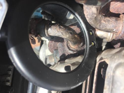

I have sanded down the rust and got rid of nearly all of it,the bottom pipe seems like surface rust but the corner of the top pipe has got ever so slightly deeper grooves in(first pic without grease),I've bought and applied some high temp brake grease (second pic on seperate page due to file constriction)  to keep an eye on it then take things from there, I didnt go down the painting route yet as I want to keep an eye on it over the next few months.

If you are wanting to see how things change I think you'd be better of painting them. Grease will attract a coating of dirt in no time at all thus preventing you seeing what's happening, whereas paint won't and should also provide a barrier to oxygen and therefore stopping further corrosion. If the corrosion does for whatever reason continue it'll bubble the paint up and make itself obvious.

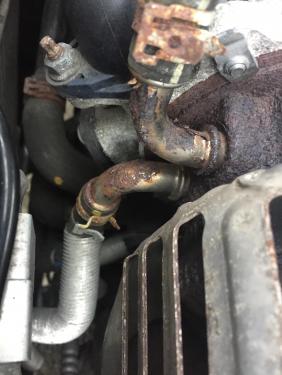

I am experiencing the same issue now. There is a clear pit in the corrosion on mine of approximately 2-3mm deep.
I have been down to the dealership and contacted CRC. The dealership were very rude with me, but the people at CRC have been very helpful up to now.
The car is no longer under warranty, but it's only four years old. Surely corrosion of this nature should not be happening so early?!
I am fuming but feel powerless at the same time.

We don't know the history of the car (have you had it from new, serviced at Ford etc) but whatever only Ford are going to authorize a repair/replacement turbo as appropriate. You seem to have had a reasonable response from CRC so far so I would pursue that line, though a dealer would have to be involved to carry out any work. Ford have issued a service bulletin on this issue (TSB 16-2088 according to others on this thread.)
Ford have been cleaning and painting the pipes with some special specification paint when they have started rusting. Yours looks well beyond that. So don’t accept that.

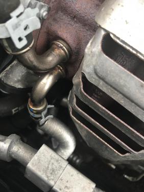

I used some heat resistant paint that is in the picture.

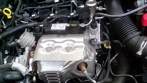

Interesting - I wonder when this was introduced?  My 2018 (pic on page 11 of this thread) still has the shiny pipes. Have you spotted any other differences?

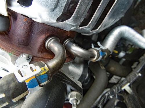

This is mine - March 2017.   Still the shiny tubes but absolutely no sign of rust.   Anyone know what the yellow and blue paint denotes?
After 3 years and over 30,000 miles on my 2016 ST-Line 140 my pipes looked like yours Bob, didn't have the coloured paint though if my memory serves me correctly.

Here's a pic of my 2018 which has no particulate filter but still has the shiny pipes. Seems to be the same heatshield arrangement.
