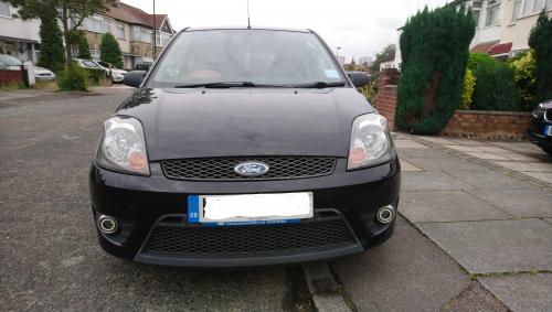

Mk6.5 fiesta zetec s upgrades
My panther black paint is in desperate need of a machine polish
Like you have done on yours black paint looks great when clean but gets dirty so quickly
You should get some colour coded Handel's they are nice little upgrade

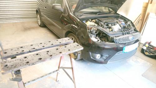

Bought a few things as stuff was going wrong. Want to thank @TomsFocus and @Fiesta1.25 for help with diagnosing the problems. You guys might not believe the date of the window motor. Might got lucky. The window switch has a little image which the original one hasn't but not too bothered about it.
Got a second hand passenger window switch, driver window motor and new boot solenoid. DSC_0091.thumb.JPG.16738015e2111dc06b203f667266df10.JPGDSC_0092.thumb.JPG.c13197d13e35a523344c7c1879975fb9.JPGDSC_0089.thumb.JPG.603a5a4a360642513d7c426e8d1a7c1e.JPGDSC_0107.thumb.JPG.e88bd80d4830d4feecd71fc097478347.JPG
Yesterday fitted everything. I also fitted a new reversing camera to replace the other one.
Starting with the motor. Old on the left, new second hand one on the right. Can clearly see how rusty the old one was. The new one is dated 2014 so only 5 years old. DSC_0112.thumb.JPG.532dcfe6beee3fbae03c6fe0eabfc50a.JPGDSC_0113.thumb.JPG.313f7bc65b595a6ed02c4a32410a6202.JPG
With the switch, fitted the new one and now looks like the window is working now.
 DSC_0111.thumb.JPG.9a461a5fd12470b201fa5f959fe43fbe.JPGDSC_0114.thumb.JPG.3a874558970b9318b1f8cb21dd07018c.JPG
With the solenoid the original one has lost its function and struggles to retract. New one works a lot better, better than when I bought the car.
New (left), old (right)
Finally fitted a new camera in

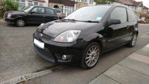

Really nice little touch up I did using a white board pen. The S badge has lost its red colour and was thinking of buying a new one but guys on the forum gave me an idea of just using a red pen.
Before DSC_0179.thumb.JPG.f35300b6fdd9b41fb905b81bb3833cad.JPG_20190528_131020.thumb.JPG.33313dea89901fb8fa6b3c4907084a88.JPG
After

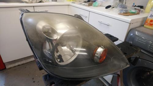

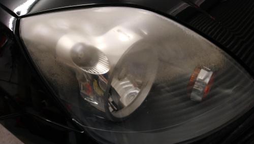

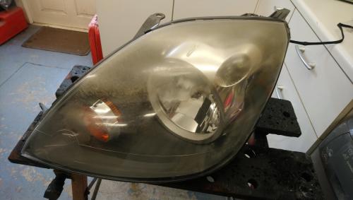

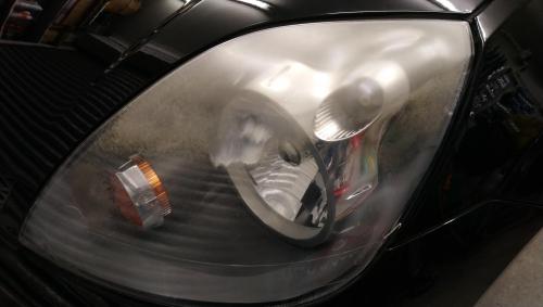

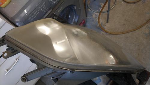

Kind of a big thing but restored the headlights on the car. Never sanded before so was scared but managed to do it. Thanks to @TomsFocus and @Luke4efc for guidance 👍.

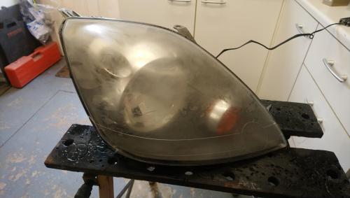

The headlights weren't in a good state. They were hazy mainly from the top half and that obstructed a bit of light from the sidelight. The right headlight had a mark where someone had tried to restore it however gave up as you can see. DSC_0195.thumb.JPG.e759f19a46c97e3e863166003965dac2.JPGDSC_0194.thumb.JPG.6c9b97532ce4de2286de9d194caf9496.JPG

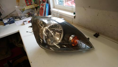

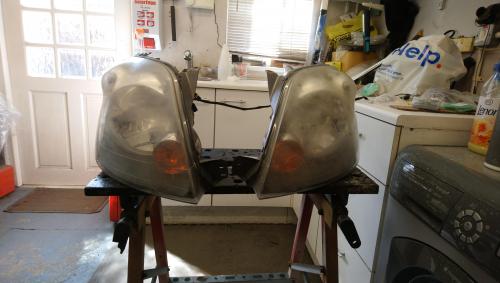

Removed the headlights from the car

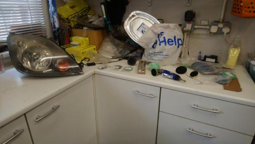

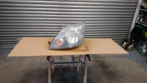

This is the equipment used. Used this air powered DA type of device. DSC_0231.thumb.JPG.276c184c9e9633cc63feba175db76449.JPG
Then started with one. Started with 1000 grit sandpaper. DSC_0233.thumb.JPG.1a892b8886ca1c699f288c721e285b2e.JPGDSC_0234.thumb.JPG.e019c4d09b53df0c5c03d762ef0426d9.JPG
Then the next one. Managed to smoothen out that mark. DSC_0235.thumb.JPG.ec817c1fe9de65af4934d00a445e4e82.JPGDSC_0236.thumb.JPG.ba8511d40e3982abe26d3f301df63bc0.JPGDSC_0244.thumb.JPG.4aeacb8a772ce7b45300595f4ce5961c.JPG
Then moved to 3000 grit. Left had 3000 grit. Did make it a little clearer. DSC_0240.thumb.JPG.3c0aec2140895a87905a27ddcbe2f218.JPG

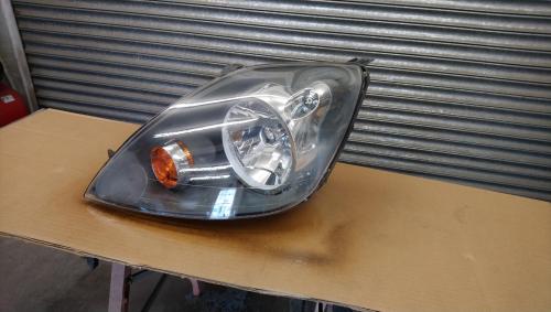

Then sprayed clear coat on them.DSC_0248.thumb.JPG.39e069c3136c86ae6f0639167745c8b9.JPG

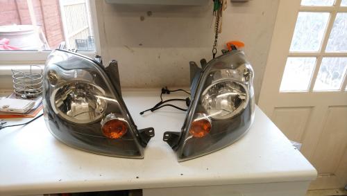

Finishing pictures. Looked a whole lot better than before just about looks new. DSC_0249.thumb.JPG.9abeae3c10caaa6c45eb884e68b086b5.JPGDSC_0251.thumb.JPG.ba86b18f3168eab6ec444e3aca253793.JPGDSC_0255.thumb.JPG.ab2cc8ce0608ae8ed08d81cb47d8e94e.JPG

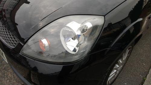

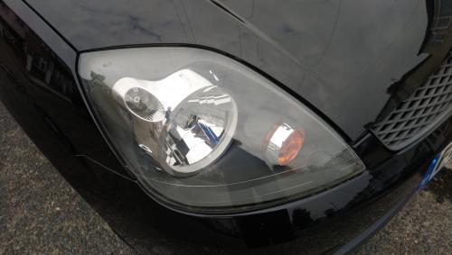

On the car_20190625_172405.thumb.JPG.be0bf03c1148f8edf04cecfa5889a452.JPG_20190625_172551.thumb.JPG.1e079fa0fd808108293d437d62082dd3.JPGDSC_0262.thumb.JPG.ce8907fac24d3c0088efe1872c8c57f3.JPGDSC_0263.thumb.JPG.d194941b4a4d5bfd89180f74b38a5502.JPG
