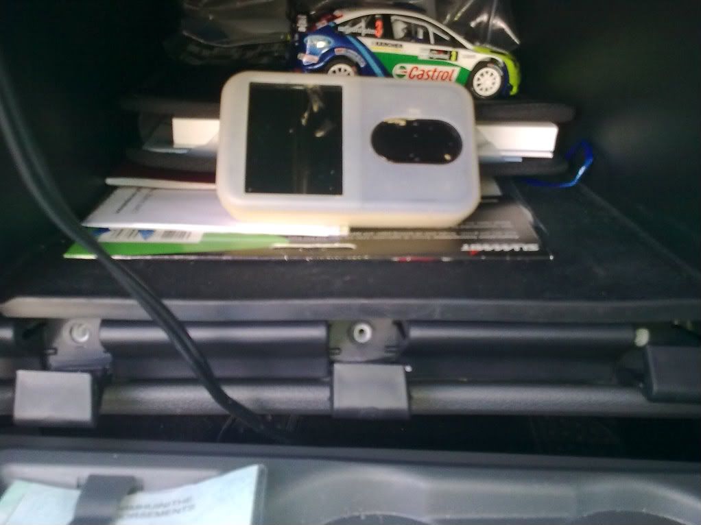

Don't think my glove box has a bulb in it (or its blow) were abouts would i see the housing for it.
I see the aircon duct on the right of the glovebox - only other thing is some grey thing at the back - is this were the bulb goes????

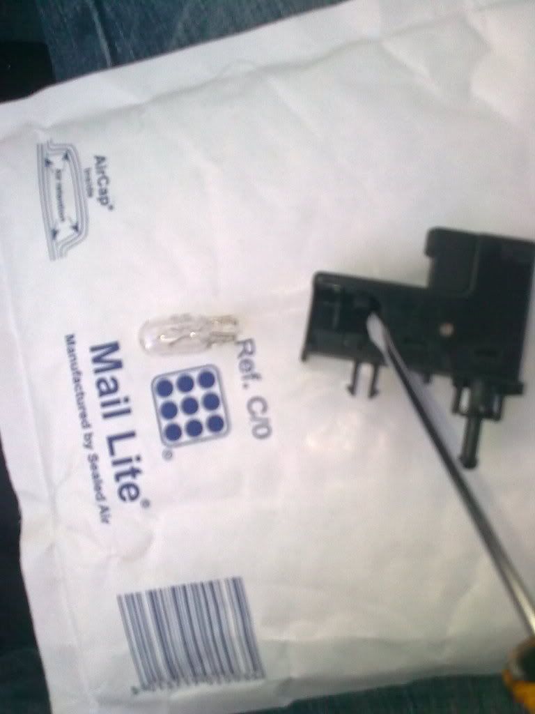

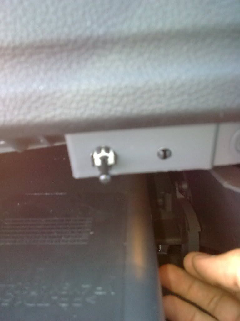

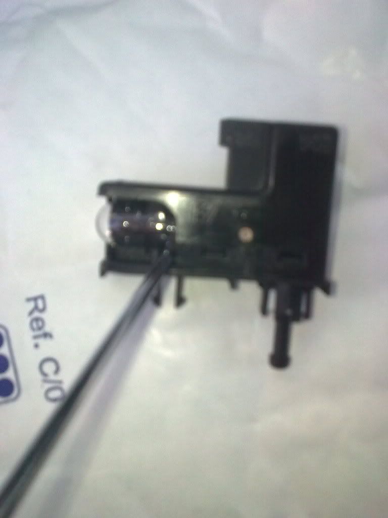

Sounds like the bulb is blown mate,
At the top of the glove box you will see 4 screws and a further 3 at the bottom under the rubber grommets,
See pictures below,

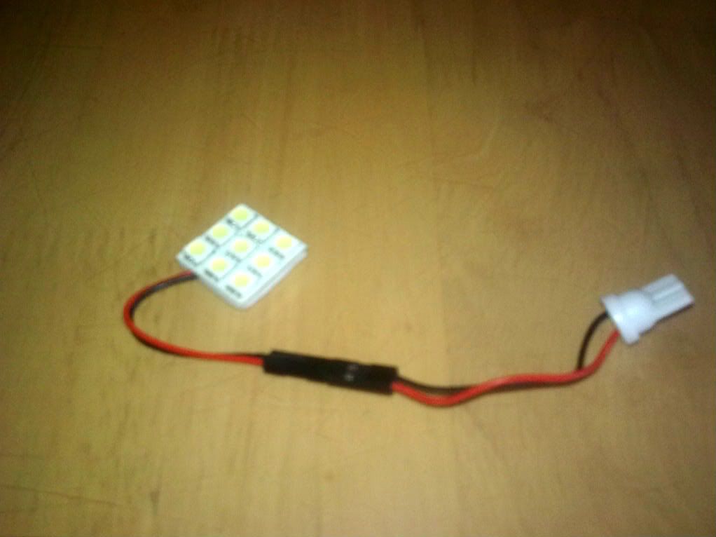

I had changed to an 8 Led but it’s not that bright when it shines through,
So I got two 9 white Led sticky back clusters (quarter size of a credit card) with a cable and fitting at the end to match the socket in the glove box,
So the bulb unit sticks to the top of the glove box and the cable goes through the hole in to the original socket,
Providing a nice white light in the glove box, if you want one I’ve got 2 of them for £10 each including P&P I can post pictures
PM me if you or anyone else would like one

Had this one below fitted, but not very bright in the fitment conditions so got the clusters built £10 including P&P if anyone wants one Mail me
