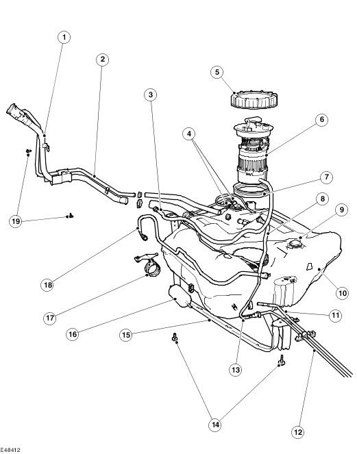

Fuel filter is number 16 in the above diagram, next to the fuel tank.
