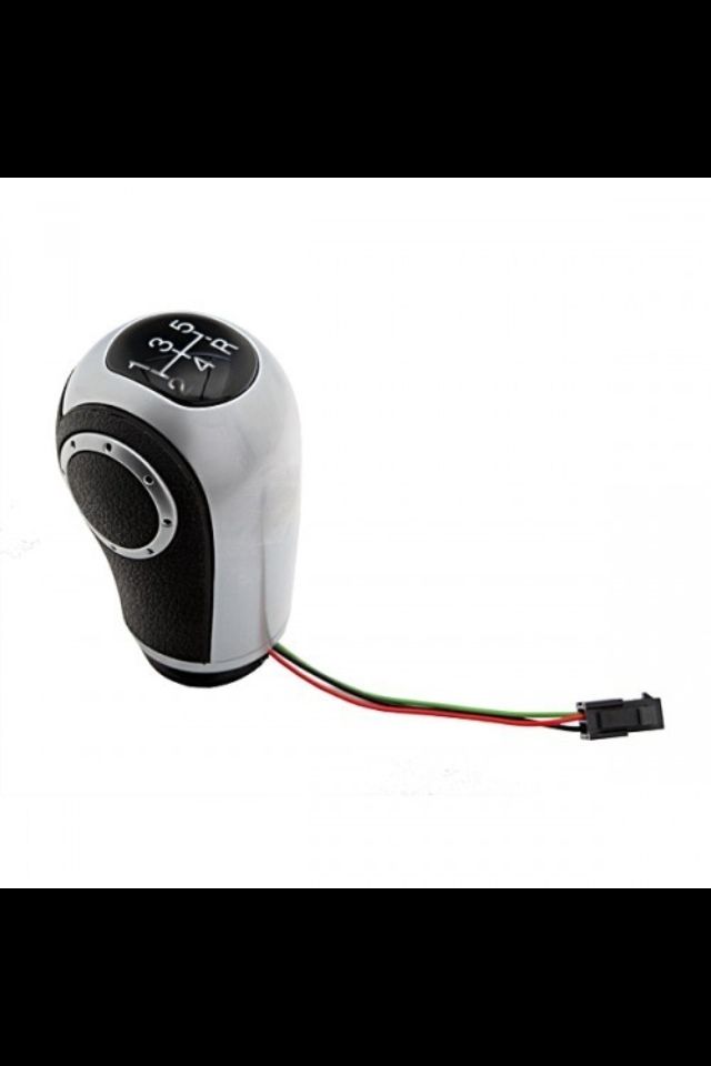

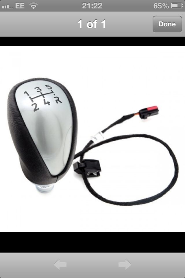

Hey guys I've come across these and I really like them I've found 2 pictures below which one do you guys like and how easy are these to install cheers.

Second one for me.
They are pricey for what you're getting (surprised with the ingenuity on this site nobody has come up with a DIY version of this but maybe there's some food for thought!) but a guy on another Focus forum was selling them through the bay for half price a while back. Dead easy to fit too, as mentioned above.
