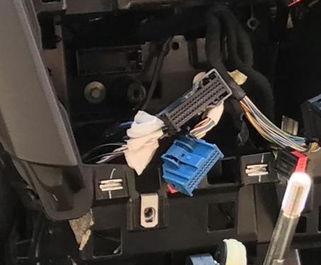

I forget the "second" picture... I suposse this is the HVAC connector Luke was talking about...
As per guide. From hvac to APIM
Dealers are pretty crap. The one I went to for a few bits was reluctant to order the bits I wanted because in his words ‘it’s a waste of time and impossible to do’. If you get them your vin they will only order what your car originally came with.
The hvac plug is the blue one, you need the twisted pair (grey/orange and purple/orange.
The connectors you are using are not great to be honest, they don’t always connect properly and can cause all kinds of problems, you should really be splicing into the cable and soldering your connections.
Think it's pin 5 and 6 on the Blue connector.

Many Thanks, Luke... Now I have everything really clear. As I told, I'm not able to have the electric soldier close to the car, so I decided I'm going to look for a gas soldier... I was using it when sailing on Antarctica just to solder connectors :). This job is not difficult for me, I've been working as seismic engineer for several years on board an scientific research and many times I had to soldier wires on a 120 underwater pin connector in the middle of a storm, but my pulse now is not for stealing jingle bells.
