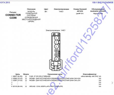

Pin 1 -  12v ?
Pin 2 - Sync pin 16?
Pin 3 - Sync pin 17?
Pin 6 -  Ground
This GPSM module have built in GPS antenna?
That looks correct to me. And yes it has a built in antenna

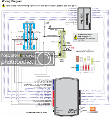

I connect  this 2 cable ( pin 2 ans pin 3 from GPSM) to BMC MS-Can + and MS-Can - C2280A
Now I confuse 🙂 I need disconnect from BMC and connect to big blue connector on the back on the air on/heating control panel?
Now I confuse [emoji846] I need disconnect from BMC and connect to big blue connector on the back on the air on/heating control panel?
Keep them cables connected to where you have them. You now need two more strands of wire to make a connection between the HVAC connector and the GPSM module. This allows the GPSM module to show up on the correct canbus and therefor allowing sync 2 to use the module :)

Ok connect to grey/orange and purple/orange, no pin numbers?
Looks same MC-CAN to me 🙂
Correct. I stripped a bit of the plastic off from the wire and soldered to cable to it and then wrapped it in electrical tape. This should 100% sort your issue

Think it's pins 5 and 6 on the Blue HVAC connector.
Just noticed you have a Kuga so might be different as mine is a focus. I didn't have the Blue connector but I found the ms can in a big connection by the passenger foot well. I took the pin out of the connection which allowed me to slide the heatshrink up after I soldered the splice wire on but it's pig of a job!!
I connect to same connector witch is MS-CAN but still nothing. Maybe I need something change in config for this GPSM module. Before I have blue fakra antenna only.
