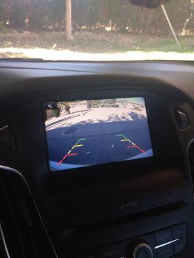

And, now a new question.... do any of you added an aftermarket rear camera to an retrofitted SYNC2??? As I used an extension cable fro 54 pin re-wirings, and the cable had a RCA connector attached to pins 14 and 15, and I didn't remove it, I'm going to install an aftermarket rear camera... but, information about configuration using forscan is really confused .... I didn't found anything clear about what I have to change... do you have any id
I've  "activated" the rear camera by using the first menu that appears on Programming and Configuration under APIM and there was an option about Rear camera / North America Camera / Europe Camera / No Camera.... I choose North America Camera (because Europe use the PAL system), now, I have the configuration options on my settings - Car... but, when I put reverse, nothing happens until 10 seconds later that I have the message "Camera not available". This is correct, because the camera is not installed but, why it takes 10 seconds to show the error message?? This disappears as soon as I release the reverse gear....
Thanks again for all information...
@simrad just wait till you have the camera
Yes, I will... 😊
Camera installed and working... No need to change anything on asbuilt mode, just in enginer mode activate as North America camera...

@Monks600 if you bought the sync adapter of amazon. Buy a long yellow rca lead and run that to the boot handle and power and ground from either your reverse light or preferably from an ignition 12v supply from somewhere. Easiest thing I’ve done yet.

Sorry to bother you, I'm still struggling with the reverse camera. My question now is: do I need a camera module or may I just plug the camera directly to the APIM?
