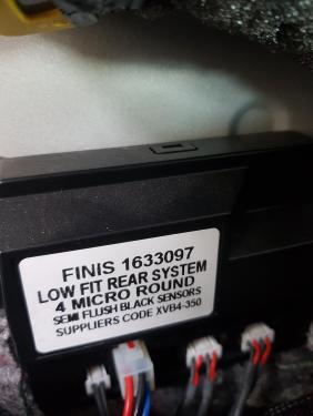

So I thought I'd share my experience just in case someone is in the same situation as me.
As far as I was concerned, my focus had the rear parking sensors and it was just a case of fitting the fronts and module to get the assisted parking.
After reading some of the post on here and talking to @Phil21185 it became apparent that I didn't have the factory fitted parking system and instead I had this.
I've now managed to get a good deal on the right sensors and wiring and now have rear parking beeping (I did have this before) and the visual representation on my Sync unit.
I intend to get the fronts, but will wait until I can buy the right colour sensors and the wiring all as one lot.
