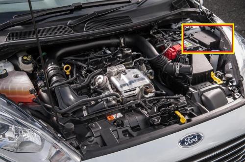

Can you take photo of the control unit he disconnected?
Can't get to the car right now but this is the bit (I realise this isn't a MK8 but it's near enough).  Take the first cover off, inside there are two sets of control cable looms with a large long grey plug on each.  The box itself is to the right of the battery.
He pulled them both, then reseated them.  There's an intricate locking mech and lever system but it's pretty simple.

I know the connectors , c1035a and c1035b.

These are the connectors that were pulled.
