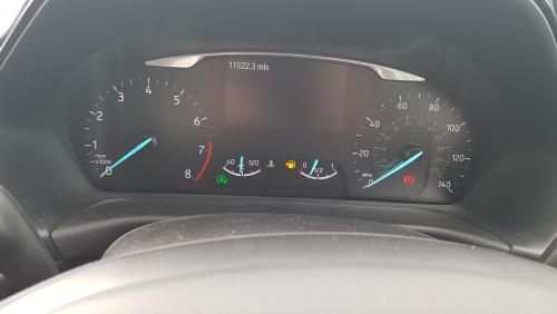

The good lady has borrowed my car and has called me to ask why the car's centre display (behind the steering wheel) is just showing the mileage.
I assumed she was looking at the trip computer but after being sent the picture below I'm stumped lol.  Has anyone seen this happen wth their MK8 ?
It's stayed that way throughout the journey and hasn't changed after a switch off/open door/start cycle.
Also the mirrors aren't folding in automatically either apparently.

How long was it switched off?
The car only properly shuts down after about 20-30 mins with the doors locked.
It might just need a long shutdown and will sort itself out.

Thanks Alex, probably only about 15 - 20 minutes.
That's the view I get when the car is unlocked but before switching on the ignition, but I see from the pic that the fuel/temp gauges are activated and some lights are on, so presumably ignition was on? Not experienced this exactly but have had some odd behaviour when parking and the stop/start has shut off the engine but I've forgotten to switch off with the button.
Hi Roger, yeah I recognised it as the standby view after the engine is off.  I've not got my hands on the car yet (SHMBO will be back later on) but I'm assured it's that way whilst driving.
No idea why it should affect the auto mirrors as well, although I can't discount something like accidentally pressing the manual fold button till I get the car back.
I've had the occasional issue with Sync etc that is usually fixed by a full reboot / shutdown so I'm hoping it's just one of those scenarios.  If not it's my first foray into Evans Halshaw Hull 🤨

Just got the car back from the Mrs and the instrument cluster is as it is in the picture, just the mileage showing.  If I press the 'OK' button or change it up or down it does nothing.  The LCD seems to be working though as it shows the Alarm dialogue on locking.
The mirrors definitely don't fold automatically anymore.  If I press the manual button they close and open without a problem but on locking or unlocking they remain where they were.

The mirror folding function is controlled via the settings menu accessed by the steering wheel controls, of course, so the box of tricks controlling that or the associated connections could be the culprit. The screen itself is presumably ok as the mileage and other dialogues display as you mentioned. None of these functions (in my car at least) can be altered via the Sync screen so it looks as if we can't blame that this time.

My lamen's guess is that the data connection to the ECU (or whatever holds / generates the information or controls) has been lost.  I'm thinking that the mirrors switching back to manual may well be a failsafe as the auto-miror setting is part of that control set.

It won't be a fuse. Have you tried going into engineering test mode to check all the cluster and information centre lights up?
Press and hold steering wheel right ok button, switch ign on and wait 5-8secs. Et should then show, release ok button and toggle using the up down

Couldn't even get into the mode.
Pressed and held the OK button, hit the start button after 5-8 seconds and nothing comes up.
Am I doing it wrong ?

That's what I did. All the normal warnings for seatbelt fastened etc were coming up as usual, "ET" came up in smallish green letters near top right of the info screen if I remember correctly (only had a brief dabble), after that pressing the menu button to right of "ok" brought up the test menus.
Yeah I don't get any warnings etc.  The only thing the screen ever shows at any point is the mileage (top left), or when I switch the car off I get the Alarm dialogue asking if I want 'Full' or not.
Probably need a software update from Ford - this seems to be getting too common (electrics worse than the old French cars)
