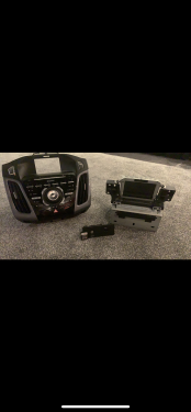

My unit is this one attached in the photo what other details do you need to steer me in the right direction lol
North south east or west 🤣?
Also does anyone know the part number for the radio facia (unit above) that will accommodate the 5''' screen?
Thanx

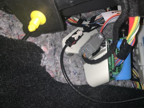

When you look under you will see 2 mins I’ll nip out and take a photo for you
3 minutes ago, Pabz0804 said:
Hi Tom, will i have to remove any trim or is it normally visible or do ford like a bit of hide and seek
Ill have a snoop tonight
Pull the black plugs off them yellow spikes. And pull the piece of carpet out. Your looking for that fakra cable that goes into the white plug next to the grey. People said it would be taped up behind the screen. I was going nuts looking for it. And decided to trace the end from the boot. If you have one plugged in yours will be behind the screen taped up. If not you will need a fakra cable to plug in under glove box and go to your screen
Tom, your a legend
