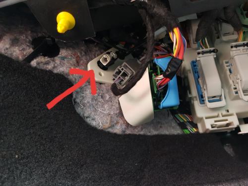

  • Pull the black plugs off them yellow spikes. And pull the piece of carpet out. Your looking for that fakra cable that goes into the white plug next to the grey. People said it would be taped up behind

Saved you the hassle of attempting to find it behind the screen. You need a fakra Z extension. Just look on amazon I’ve not got that system any more so couldn’t be 100% it will work.
Yeap defo saved me a lot of time 👍🏼 massively appreciate your help.

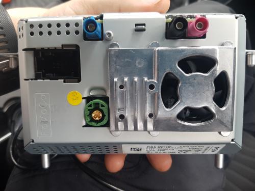

The latest design of the 5 Inch displays have a Rosenberger/Fakra HSD connector. This is a 5-pole connector (4-pins + ground). The amazon cable has a "normal" Fakra connector. This is a 2-pole connector (1-pin + ground).
If you want to use the existing cable inside the car you need a "normal" Fakra to Rosenberger/Fakra HSD cable that has the correct pinout. Such a cable will be virtually impossible to find. It will either have to be custom built or you have to build it yourself.
I recommend to not use the existing cable inside the car and install an additional (usually included with the rear view camera) RCA cable from the boot to the display. This is a lot easier than using the existing cable. The power for the rear view camera can be taken from the rear window wiper motor. The window wiper motor has a ignition switched power supply.
Thanx JW, so my screen is the 5pole connector type and the connector in the football is a 2pole, is that right?
So I would need to get a 5pole style cable from the screen, and connect it to a 5pole>av adaptor which the camera hooks into?

This could be where I’m going wrong. Was hoping to use the OEM camera I’m guessing there is no way of using this ? I was assuming the blue and green was the fakra connection on the tailgate harness
Where can I pick up an RCA to Rosenberger/Fakra HSD adapter cable like the one in your photo @JW1982
Yes, that is the correct type of adapter cable.
