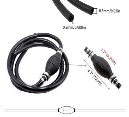

Use one of these its easy to bleed then.connect all pipes and put this on the output side(pipe to engine).Pump till fuel comes out of tube,filter now full..disconnect refit pipe start engine put revs to approx 1800 the few air bubbles that are in the pipe will soon pass.
The 1.4 TDCi in the Mk6 already has one of these in the system so much easier than the 1.6 TDCi or the later 1.4s.  Back left near the airbox. :smile:
