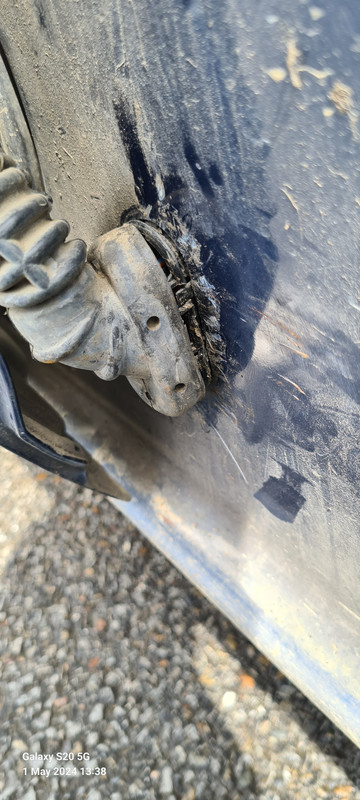

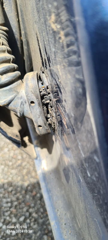

could anyone tell me if i have completely destroyed my plug please?

Looking at the condition of your harness, I think you are going to be forced to replace it. There is strong evidence of corrosion of the wires and contacts.
It's not actually a plug. It is a though body connection (not the same thing).
If you use a flat blade screwdriver you will be able to leaver out the plastic part, from the bodywork of the car. Refitting them is not perhaps the way you would expect. You need the full plastic housing removed from the car and then you fit the rubber boot over the plastic and push the whole assembly back in to the bodywork.
