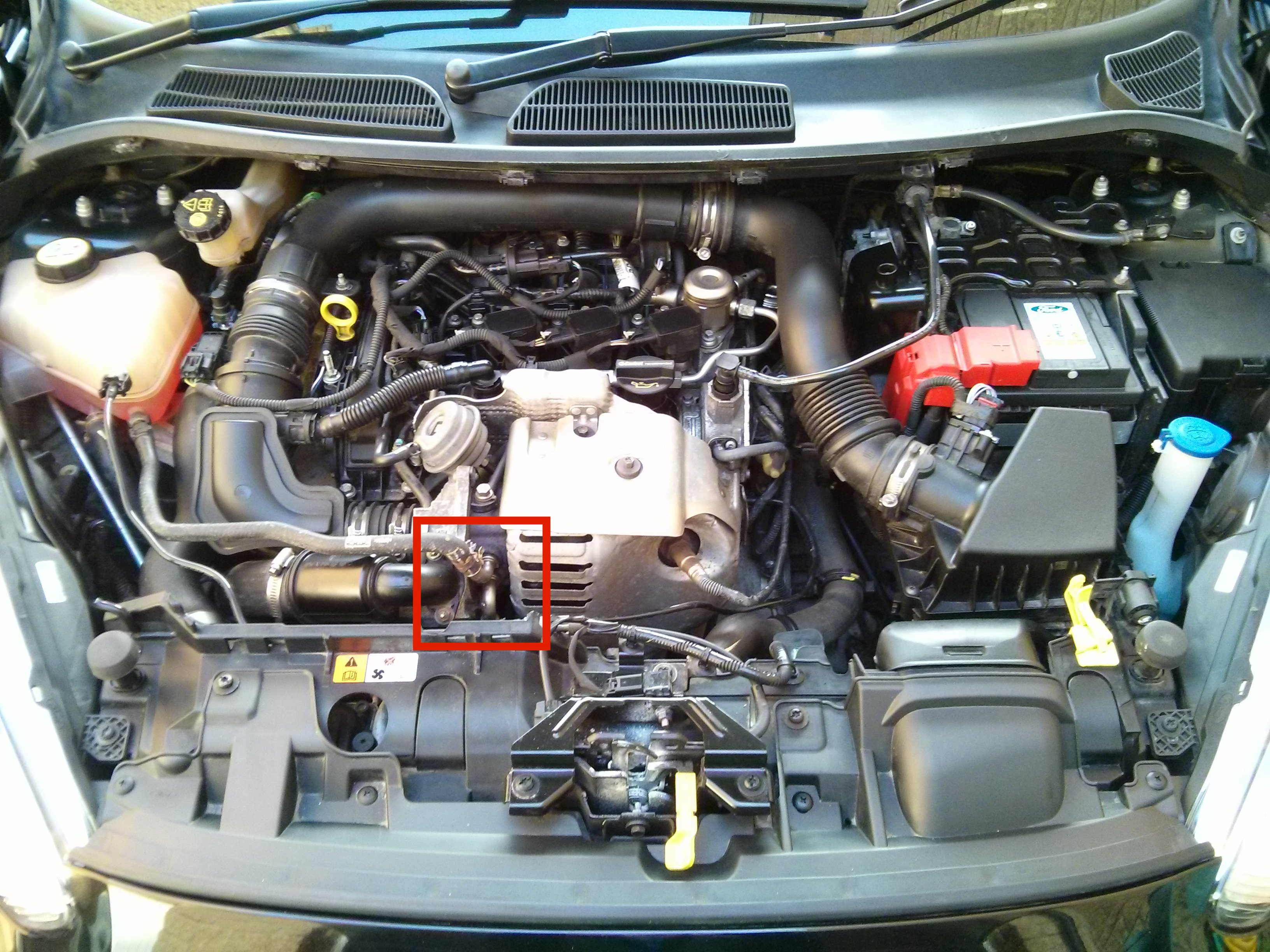

Having read this thread I checked my engine late last week and have rust on the surface on both pipes (doesn't look to have gone deep at the moment. I took the car to my local Ford dealer for them to take a look and they said they were unaware of any issues and had never seen anything like it on an Ecoboost before. Their initial advice was to "keep an eye on it" but when I made my concern more clear the recommended rubbing the surfaces clean of rust and to apply some VHT paint to prevent further corrosion. I'll be sending an email to Ford UK to get their view on the problem, and I'll include these pics together with the link to the Danish info posted earlier. Given what appears to be a low number of cases I won't hold my breath for a positive response. The car has done 45k and has had 4 services since new.
your dealer i would have thought should be looking at these pipes when in for service/repair and cleaning/coating as required.
unfortunatly it seems the inspection and repair is only for denmark . bit strange as surely the corrrosion wouldnt stop at the denmark border??

  • I'm living in Denmark and can elaborate a bit on this.   It IS an issue, if it corrodes through, the turbo will die due to no cooling. You definitely want to get it fixed, however it's proba

I visited my dealer this morning for them to take a look. They hadn't seen this issue before and weren't aware of the Ford Denmark announcement. They did however agree that it really ought not to happen at such an early age/mileage and managed to find a TSB (16-2088 I think if anyone has access to them?) which references the problem and, in cases where the corrosion is only slightly as in mine, the fix involving the application of a water-based epoxy primer and paint.
They took some photos and sent them off to CRC with a report and a request for warranty cover. CRC have just called to say that the warranty department have not honoured the request (with it being out of warranty and not a recall issue) but that they (CRC) will send me an £80 voucher to cover the cost of the repairs (£71?).
I'm obviously disappointed that the pipes rusted in the first place but accepting that they did I'm quite happy with the resolution.
what does the repair consist of? application of a water-based epoxy primer and paint? is that what costs £71?
I didn't get the opportunity to read the TSB in detail but did my best to glean what I could on a angled screen! But, yes, that is likely essentially it. I'm sure there's some prep work to remove loose rust, masking off, perhaps a couple of coats (it's obviously important to create a non-permeable coating) etc. Thinking about it now I definitely saw two items to order and whilst I've assumed one of them is paint I'm thinking now that it might be tannic acid - the likes of Kurust and similar products, some of which can be quite expensive even in small amounts and so the primer could be left as the outer coating.
Do we have any Ford mechanics (or others with access to ETIS) that might be able to dig out the TSB?
its the epoxy primer and the activator. only 1 coat needed

nope, thats about it, clean off rusty bits, wipe clean , apply the primer to both pipes and the hose clips if neccasary.

@MJNewton any photos of the repair work?  Do you know if it a high temperature product or just standard epoxy? Thanks
I've yet to have the work done as the goodwill voucher only came through yesterday. The thing is, the voucher can actually be used for any servicing/parts (excl. fuel and lubricants) and so I'm wondering if I should perform the work myself and spend the voucher on something else. The main driver is actually that I'm not keen on the thought of a mechanic chucking paint around my engine bay as even the photo in the TSB didn't seem to suggest that neatness of application was of any importance!
If I do do it myself I think I may just go for a standard Hammerite paint as it ought to exhibit all the required properties in terms of temperature (upto 150ºC), longevity, corrosion resistance etc. Available in a variety of colours too! ;-)
