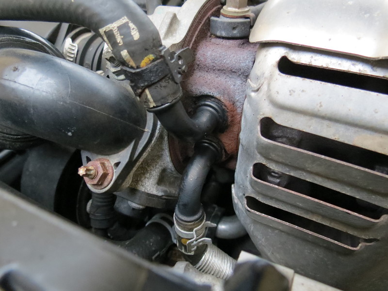

The rust on yours does look bad, it is not superficial, it is eating into the pipe good and proper. In my opinion it is past the rust proof paint painting stage.

Either way, here are a couple pics of my de-gas hose. I think I'm right in saying it's the kind that was recalled for the Focus, and that I'll probably be needing it done along with my turbo! It's hard to show properly on a photo due to the angle, but that crack really doesn't look healthy..
Cameron Ecoboost2013 (who started this thread) also had both the turbo and de-gas hose replaced, so the problem parts possibly tend to come as a pair.

And on that note here is a picture of the pipes in my 66 plate (13 months old) 125 Ecoboost. The rust is deep enough to flake off with a thumb nail.

This one above is a 66 plate from page 4. There are also a number of >2015 plates that have had this issue on the Facebook group.
And this is just what you can see of the inadequate cooling system on the 1.0 ecoboost. Some of the failures have apparently been down to failures of small internal components of the engine. Could this be down to corrosion too?
You'll get those who say that this is just a small sample of an engine that has sold millions. But this assumes that everybody who ever had this problem came to this forum. It also assumes everybody has checked their engine too.
It's pretty shocking that, in this day and age, rust is setting in on cars less than a year old in some cases. Especially on the cooling system which by its nature has water in it and goes through a heating, expansion, cooling, contraction cycle every time you fire up the car. By its nature the cooling system calls for high grade parts. Ford have clearly just been cutting corners or just not bothering with quality control. There should simply not be rust on these cars. Any of them - even the 4 year old ones.
