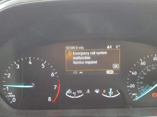

Emergency Call System Malfunction.
Driving home last night - parking pilot malfunction, auto hold malfunction and emergency call system malfunction one after the other! The auto hold and parking pilot malfunction seem to have cleared themselves but the emergency call system malfunction message is still showing. So car is now booked in to TrustFord for a week on Monday.

    Not seen that before, I would try removing the fuse in the first instance, or disconnect the battery for 5 mins. The code is built into the APIM\BCM so it will reset itself fine. To quote the IT

I’ve had these issues for a while now, initially I was pressing the emergency call button and immediately cancelling it which sorted the problems for a day, I then read about fuse 11 and tried that, I’m at the stage of doing this every week now until it’s in for a service, shouldn’t be long as I’m on 35k already.

Well, after about a month of mine working perfectly, Emergency call system malfunction is also back for me.  The Fuse 11 trick is what worked for a month.  Now back to dodgy sound etc.  I even had it tell me it couldn't communicate with the camera this morning.  The joys of modern cars with too much technology that the manufacturers have no idea how to program, troubleshoot or fix.

Had mine serviced today, was told they didn’t have time to look at the problem and that Ford were now aware of the issue and a software fix would be out by April, until then I was advised to keep pulling fuse 11 every time the issues started creeping in(currently weekly regardless of mileage).

The car went in over the weekend for a couple of days, and I was told " the Telematics Module has been replaced, and everything works".  It does seem to, no messages about the Emergency Phone - so far!
