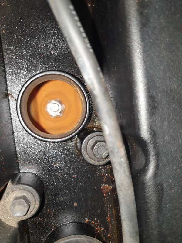

this is what my well is like:
Looking at that photo there is definetely water from somewhere.  Normal culprits are washer jets (as you mention) or check the core plugs for leaking, another common problem, cheap and easy enough to fix if they are.
Spray the area around the threads with penetrating oil, when the engine is warm, a couple of days, each day, before you plan to remove them and fit new.

rain comes from the right side windscreen washer jet and dumps 3 litres of water in the bit where the plugs sit - proves how modern materials work - as the whole thing can be underwater and the car will run and burn off the water - take a look after a massive rain shower - but it does put more stress on the coil pack and plug leads (its a shocking design - pun !!! ) and they will fail in the end
same engine on a volvo got a trim cover bit you can buy on ebay cheap - and the bolt holes are there on the ford !!!!  or take the lid off an ice cream carton and cut a hole for the oil filler cap and then one cable tie holds it in place - hers been like that for 3 years seems to work, sealing the heater washer jets didn't and is a faff
I expect the design feature was to cause the core plugs to rot out and overheat the engine...

I have noticed water on top of the cover a few times before, but have never seen any inside the plug wells. However there is a layer of brown dust in there that looks the same as the other photo. It has obviously filled up with water at some time in the past.
Not necessarily. It could be just years of condensation in cold weather.
