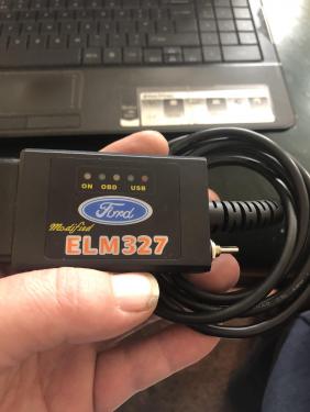

I was just about to say my elm327 will not connect to my ecu thanks tezza saves the day  thanks   By the way anyone in London or close to got UCDS  and is willing to do it for me ?

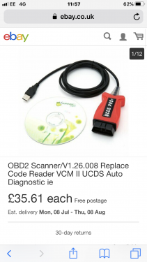

Seen ucds on eBay from China are they any good and do they work   Thanks
No mate they will not work its the Russian one you need

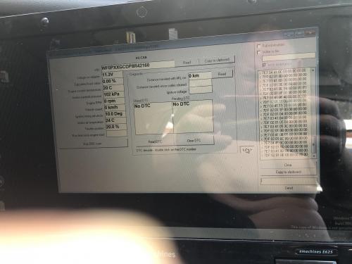

Tryed it. It works but when I start an obd scan it just keeps on scanning
You might need to download the runtime pack or make sure your on the correct port
https://www.jamessimpson.co.uk/host/RuntimePack.zip
I added the runtime pack I start an obd scan it just keeps on scanning the same

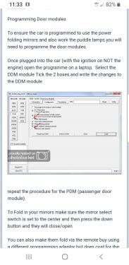

What page you reading there ?  you only need to go into ddm and pdm
That’s were it when on its own  I only opened the port

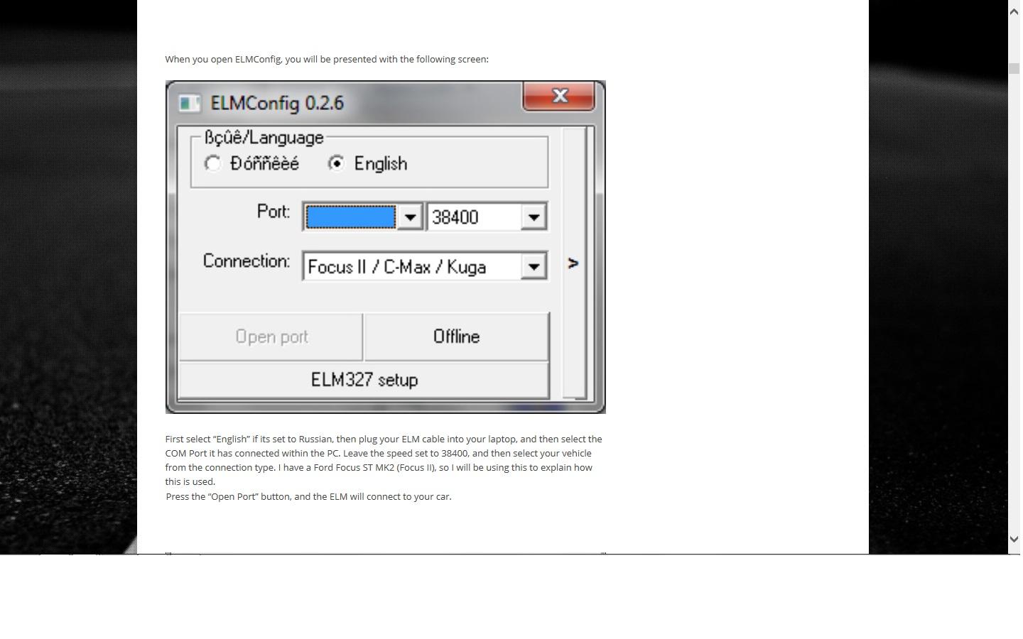

Did you highlight focus mk2 in the connection tap
Yours are easy it’s a mk3 a 2015
No focus come up tezza
should come up like this when using the drop down arrow in connection .
This what I get
try clicking on FTDI then connection
Tezza your the man ty it’s done   Even told it I use Ron 95 fuel great thanks all
