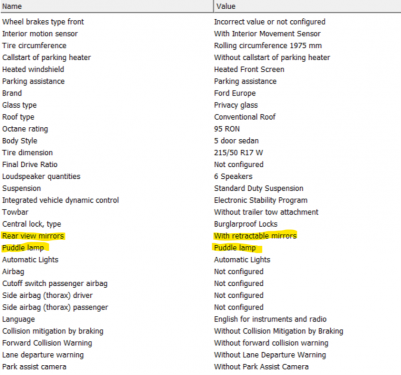

Wezaa Posted June 24, 2019 Share Posted June 24, 2019 44 minutes ago, mastachaz said: Good to.go then Great. do you know what needs to be activated in forscan? thank you Quote Link to comment Share on other sites More sharing options...

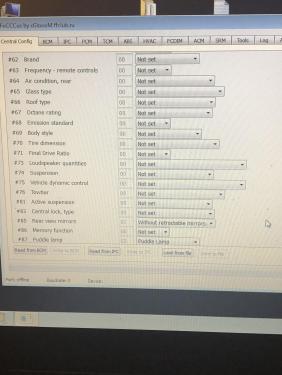

mastachaz Posted June 25, 2019 Share Posted June 25, 2019 10 hours ago, Wezaa said: Great. do you know what needs to be activated in forscan? thank you I used focccus with some obd cable Quote Link to comment Share on other sites More sharing options...
Wezaa Posted June 25, 2019 Share Posted June 25, 2019 2 hours ago, mastachaz said: I used focccus with some obd cable Just had a look using forscan in BCMii and found the retractable mirrors and puddle light. i haven’t installed new mirrors yet, but I have activated both these for when I do get the mirror. Still have the 2 month free licence for forscan, so might as well use it. Haha. Quote Link to comment Share on other sites More sharing options...

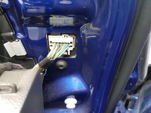

mastachaz Posted June 25, 2019 Share Posted June 25, 2019 if you have 12 pins then you can instal BLIS but that need looms and modules as well not just mirrors - around 600+ Quote Link to comment Share on other sites More sharing options...
mastachaz Posted June 25, 2019 Share Posted June 25, 2019 39 minutes ago, Wezaa said: on a related note. Ive discovered there are also wing mirrors that contain "Blind Spot Detection" on top of everything else. Does anyone know if these would work simply by plugging in and activating something in forscan? if you have 12 pins then you can instal BLIS but that need looms and modules as well not just mirrors - around 600+ 43 minutes ago, Wezaa said: Yes that one Quote Link to comment Share on other sites More sharing options...

Wazzer71 Posted June 25, 2019 Share Posted June 25, 2019 Will these work for the two wires ends I’ve got to put in Thanks Quote Link to comment Share on other sites More sharing options...
Tezza Posted June 26, 2019 Share Posted June 26, 2019 Not to burst anyone's bubble but if you are fitting these to a mk2.5 focus 2008-2011 the FoCCus software will not be able to active the mirrors as that program, is for the 2011 onwards focus, You need the elmconfig software http://civil.iffc.ru/ELMConfig/ this will turn on the mirrors and the puddle lamp but will not allow you to enable folding with remote (only via the switch inside) there is only one program and adaptor that will allow you to do this and its called UCDS. Quote Link to comment Share on other sites More sharing options...
