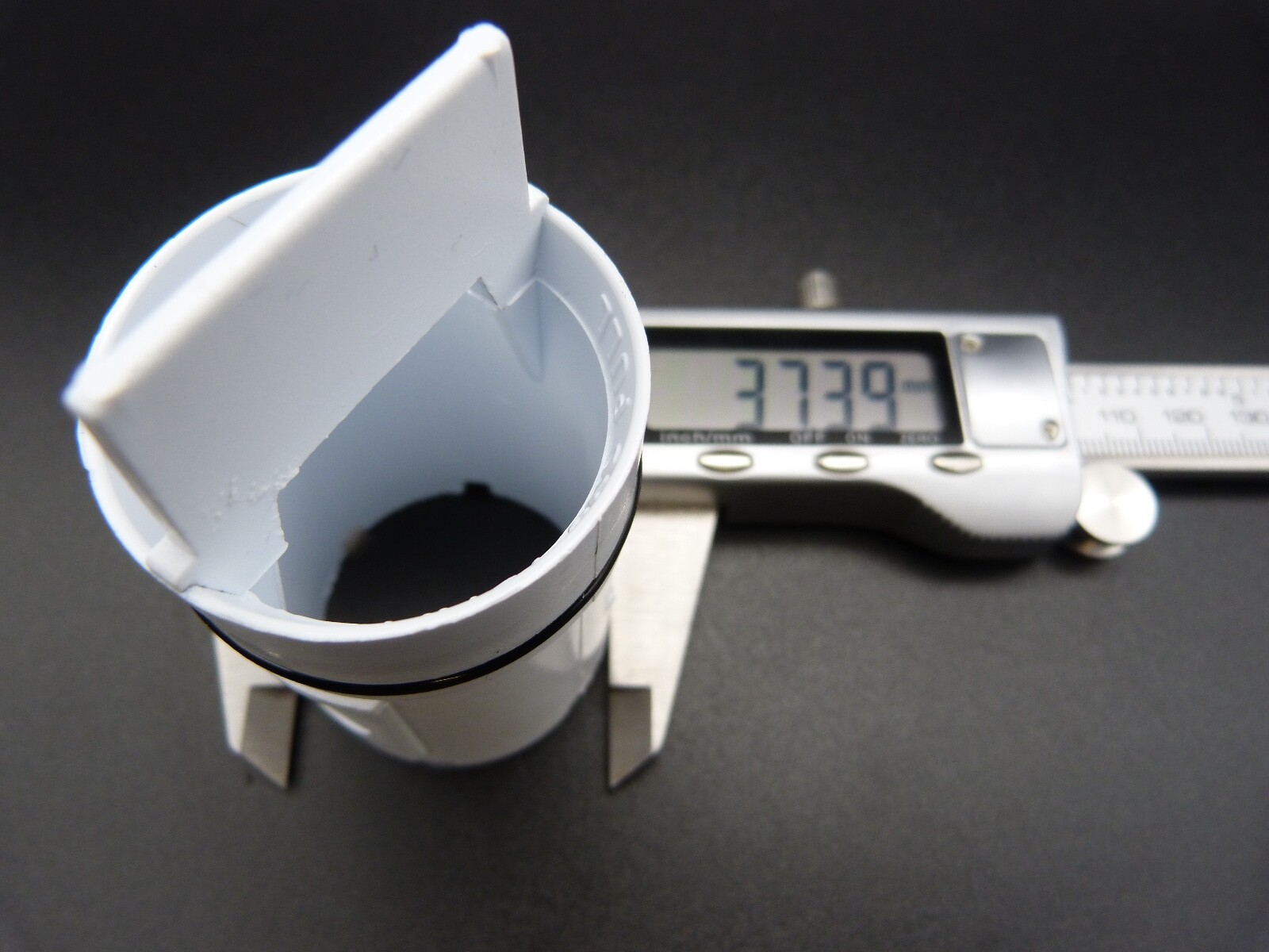

There was no smell last night, but the downstairs tenant was out, so not really a fair test.  (Also found out that parcel tape on a shower tray is a bad idea, created more mess to clean up lol).
But I'm more confused than before now.  I had assumed it would just be a U-bend like a basin, I didn't realise what you meant by a modern or traditional shower trap yesterday.  I've now found out the top grate comes out easily, and there's a plastic pipe inside that can be lifted out with a flat bar on top.  I expected some sort of filter (grate or gauze) at the bottom of this pipe, but there isn't anything.  It's listed as a 'hair trap' but I don't understand how that's meant to work?  There's obviously nothing in it to 'clean' out. :unsure:
Picture 1 of 10
Picture 8 of 10
The only thing I have noticed is that mine no longer has a rubber O-ring fitted.  But what is the point of an O-ring around a huge empty hole?  I must be missing something here? :unsure:
Picture 1 of 10
Picture 8 of 10
The water outlet in the outer part of the Trap will be part way up so will form a seal in conjunction with the part that you lifted out provided that everything that should be there is actually still there.

This looks like your one @TomsFocus, the other seal might be missing as well.image.thumb.png.4a6e7d09583064888a8f19226c4d8247.png
I'm very surprised that your one is so clean.
That's just a picture I pulled form the internet.  Mine is a bit stained (dark blue - shower gel I guess), but there's nothing 'caught' in it like I was expecting.  How could anything get caught in an empty pipe?
I see what you mean about the seal now though.  Effectively this pipe is one half of a U from a traditional U-bend.  So without the O-ring there, could that change the water level and allow more to drain out than it should, leaving the waste pipe open?  I don't mind replacing this part for a new one with an O-ring fitted, just trying to understand if this is a potential cause for the smell or not.
